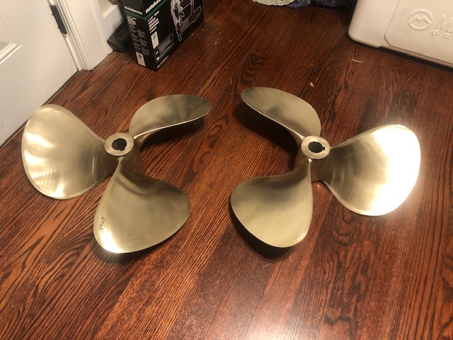

  12. Stainless45
    Stainless45 Active Member
    Jul 19, 2019
    173
    Post 46 Long Island NY
    Got my original 3-blades tuned up by Johnson Machine in Freeport to 26x26 the original specs for the boat. Huge thanks to Rich M who gave me his old wheels as spares- 26x28. Now I have a "hot rod" set to try if the ones I have don't get the speed I'm after
  13. DOCKMASTER
    DOCKMASTER Senior Member
    Feb 26, 2012
    1,661
    Ketchikan, Alaska
    They look great. Let us know how the numbers look once you get back in the water. Are you doing a blue-fit to check your contact area % on the shafts? Did you do aN NDT on the shaft ends while you had the props off?

  15. Stainless45
    Jul 19, 2019
    173
    Sorry just realized I never updated this thread. So the 26x28 3-blades went on and she flew right up to 26 knots in the spring... With 1/3 fuel and no water onboard. Loaded her up and lost about 300 rpm and made a little smoke. Took those wheels down to 27" pitch and she seems to have found the sweet spot. 2350 rpm and around 24 knots give or take. At 2000 rpm I'm making 20. Good enough for me.
