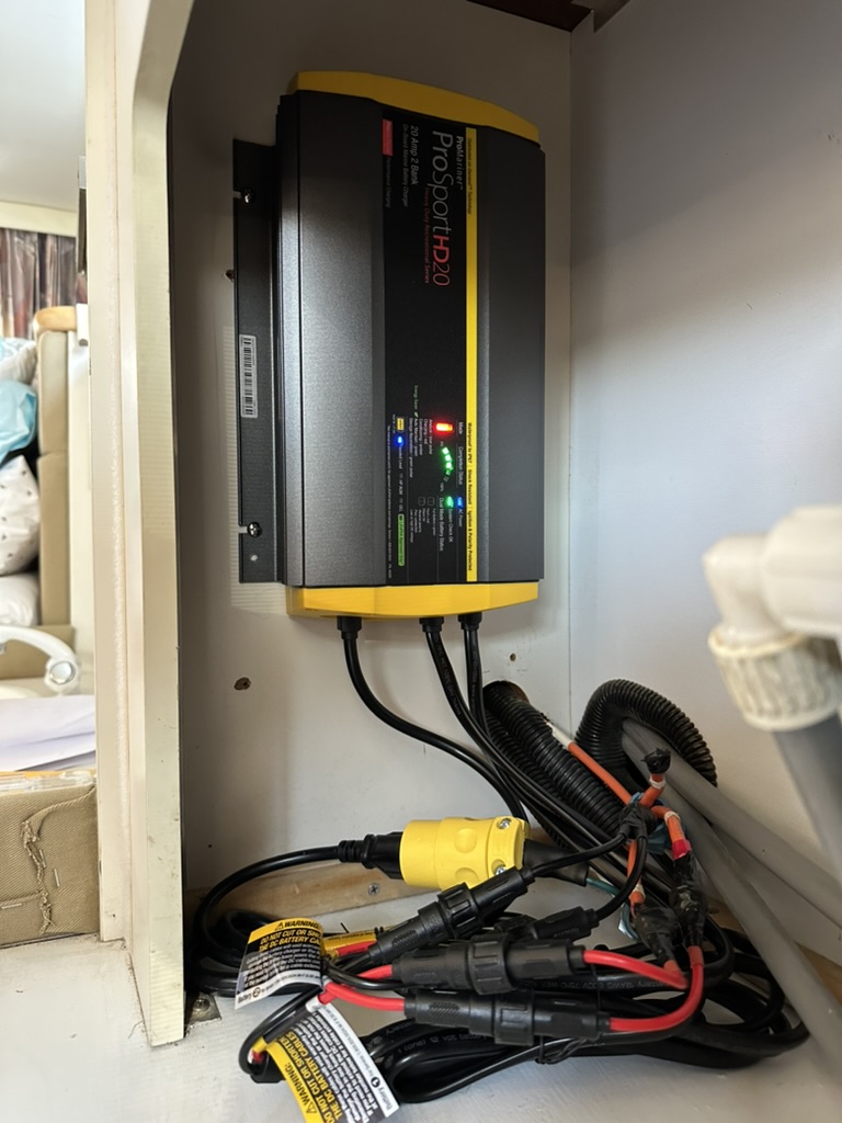

    Did you ever figure out where that third lead went to?
  13. MBevins
    MBevins Senior Member
    May 23, 2008
    1,265
    Windsor On. Canada
    You missed it, no where. Dead wire.
  14. aldera123
    aldera123 New Member
    Aug 7, 2024
    19
    USA
    I didn't follow it but it wasn't connected inside the charger unit. It was just wrapped in electrical wire. I think they might have made their wiring harnesses with the 3rd wire in case the customer added the generator. Or maybe there was an option for a 3rd battery.

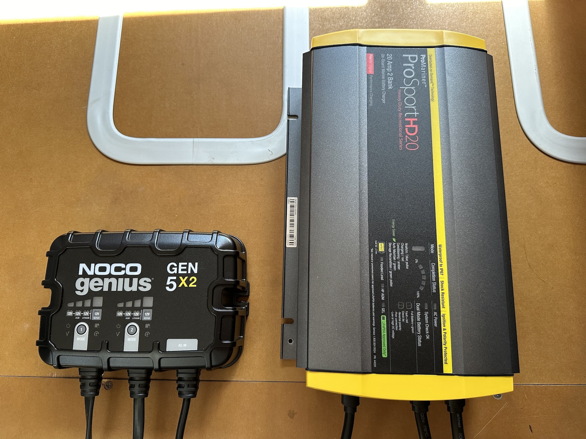

    Final Update
    Well, in case anyone is interested, here's my final solution. I went with a ProMariner ProSport HD20 - a 20A 2 bank charger. It has "distribution on demand" so it can put all 20A to one battery, if needed. Physically, it's about 4 times larger than the Noco Genius I replaced. I'll be using the Noco for my battery maintainer when I take out the batteries for storage this winter.
    Thanks for all the help and info from everyone. I appreciate it.
