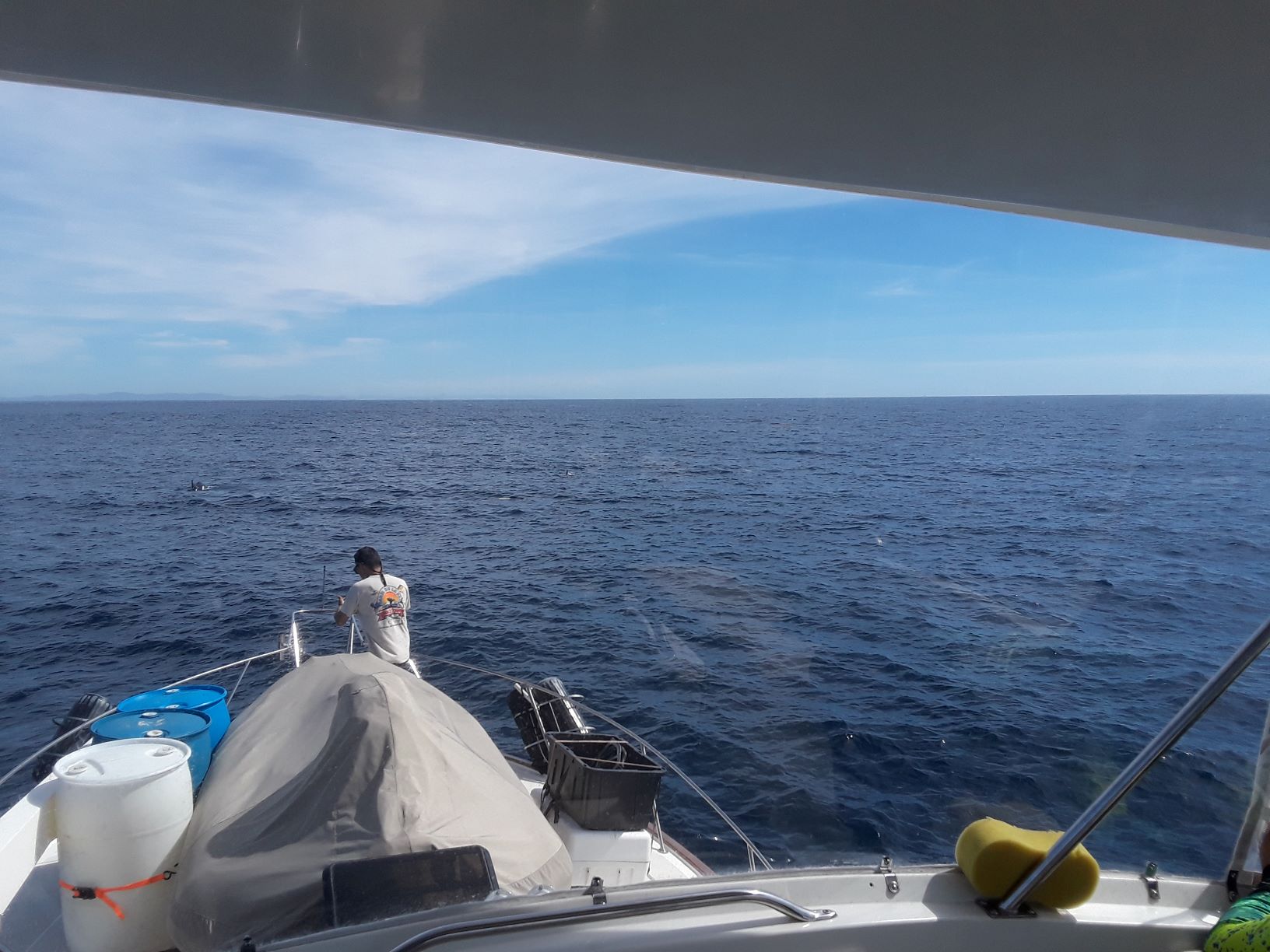

    I have a 1987 Ocean 44SS with an Avon Seasport 360 mounted on the deck with a Bower Davit. By the specs the Seasport is about 700 lbs. This dink is nearly 12 feet in length and fits very well on the foredeck. Any longer would be problematic. The vessel seaworthiness is not impacted. No stress cracks or structural issues that I know of. The only issue for me is that I can not achieve spec wot RPM which could be due to that much weight on the bow, still investigating. Attached is a picture from the flybridge, excuse the clutter from a long range trip.
