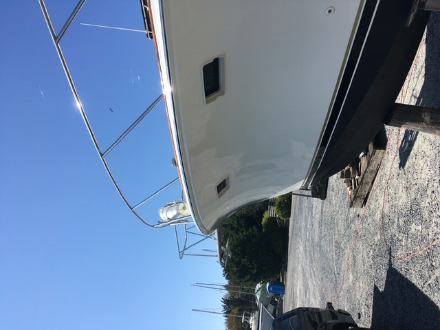

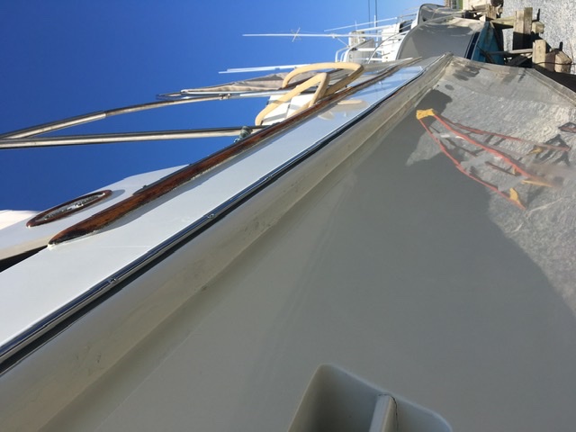

    How does that stupid song go ?
    “ It’s all about the base, the base..?!” Lol.
    Got all of it on yesterday.
    Not perfectly Straight due to a few uneven hull/deck joint spots along with a few mistakes by me. FCE8F6BB-4549-431C-85D1-680C2AF576A5.jpeg

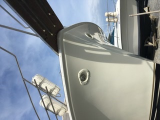

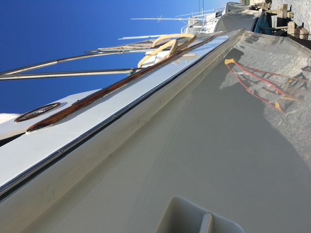

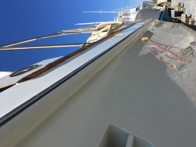

  10. cleanslate
    cleanslate Senior Member
    May 29, 2018
    1,661
    Cherry Hill, NJ
    Ok will do. It's all about what your hull/joint looks like, the shape of it. Yours it probably different shape then mine. Ocean seemed to change it up over time. You have to fine the right base that best matches your hull/joint. My kit was 2 @ 48feet long. I had about two feet left over. Boat is 42 ft ;transom beam is about 11'. Look at Great Lakes Skipper and Taco web site for all the different rub rail base combinations. my job for everything , screws, 5200, rubrails = $1000
    Your boat $1500 or so.
    Labor if the yard did it; removal, clean out seam,paint , caulk, install = 40 hours two men $200 per hour = $8000.
    I can not boat like that. Got to DIY or I would never have a boat.
  11. cleanslate
    May 29, 2018
    1,661
    Cherry Hill, NJ

    Haha, cleanslate that shiny rail is begging for some rubbing! Nice job.
