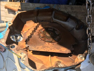

    If it is the adapter plate, please examine the clutch front input shaft seal carefully.
    Behind this seal is the oil pump. When that seal leaks, it make a mess and you may loose oil pressure.
    Some times it's good PM to replace it while it is in sight.

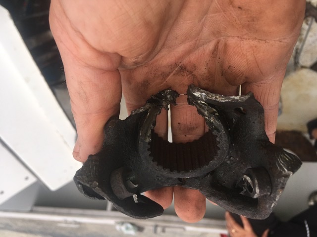

    The flex plates are built so that the hub will spin if you hit something or get a line fouled in a wheel. They're junk after that but it sometimes saves more expensive components.

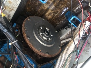

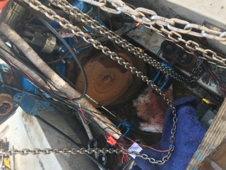

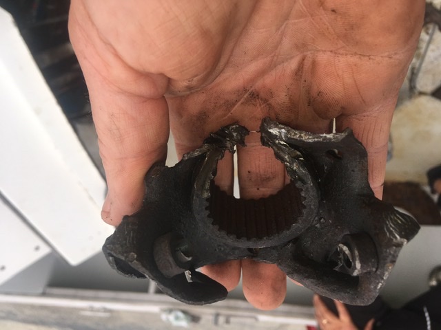

    It’s the damper plate , it’s broke off near the bolts to the flywheel. It’s thin and rusty….original 21 years old.
    It’s stuck on the trans spline …for now .
    Work in progress…

    Here we go…what’s this we? I go…yay!
    Cheap three bolt damper plate. My Crusader parts manual shows a 6 bolt plate. Lame . I’m 99% sure this is original factory plate. Factory blue paint was still in tact.
    Ya even get Screwed from the engine manufacturer don’t we. 13E2B6E4-E47E-4F6D-BDA2-EAC12735A6E6.jpeg

    Jess,….I mean yes I did . The best I can.
    Got that low profile rule pump.
    Work well. It will always get some water in there. Now that I’m into it
    motor sits about 2” above the hull.
    Oil pan and trans sump in some water most of the time.

    You get the plate off the in-shaft O K?
    Remember to look over that front seal.
    Then, Ospho and paint well your next plate. Fresh high grade bolts and lock washers and anti size on the bolt threads and in-shaft spline.

    The trans seal seems ok.

    Having a grand time getting the old flex plate off the transmission spline….
    Yeah , yeah I know . It’s been soaking in PB blaster for more than a week.
    Using a puller and still not moving .
    Tried heat also.
    I’ll get it some how.
  12. cleanslate
    cleanslate Senior Member
    May 29, 2018
    1,661
    Cherry Hill, NJ
    7DEF42EB-1B6E-4ACB-8064-2D38A0391A4F.jpeg Had to cut and cut some more to get the old flex plate off the transmission very carefully with my 4.5” angle grinder.

    The proper new one installed.
    6 bolt flex plate .
    Everything back together now bell housing , trans , motor back in place today.
