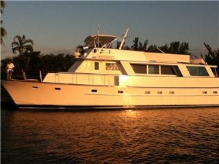

    She’s anchored of peanut island in West Palm Beach Florida. 4D61687B-7E08-4DCE-9771-0E763122A5E6.jpeg
