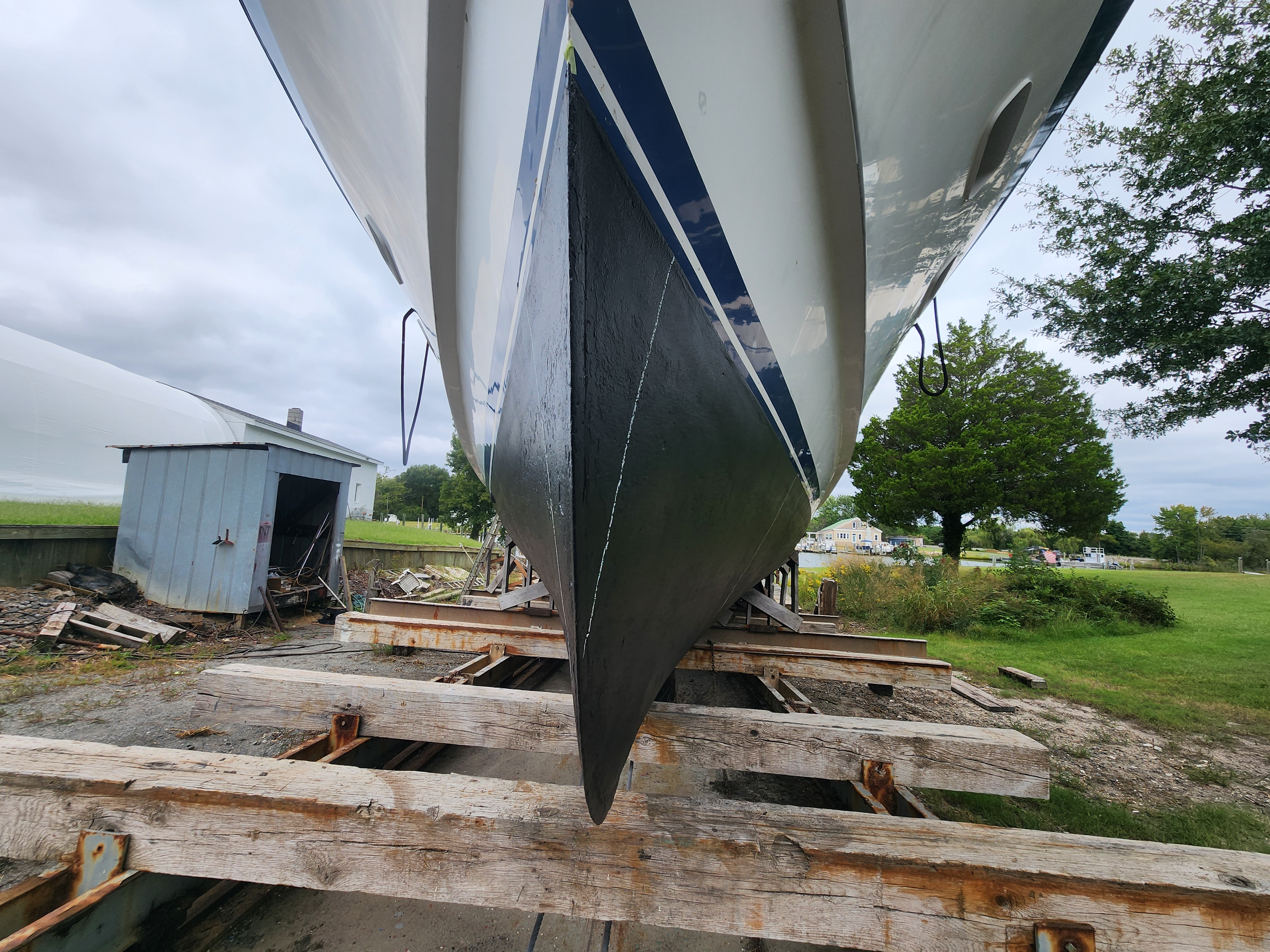

    I'm in complete agreement. Step one is to have her soda blasted to see what we're dealing with, and have a full audio guage performed. The leak is located a few inches above the bottom of the keel just fore of the boundary weld of the main and reserve tank, and it just so happens to be where she was sitting on the I-beam of the rail system. She sat there for multiple days before the leak showed itself, so I'm leaning to beleive the weight of the vessel on her keel on the I-beam led to this leak. I should have a better understanding of the issue later this week.

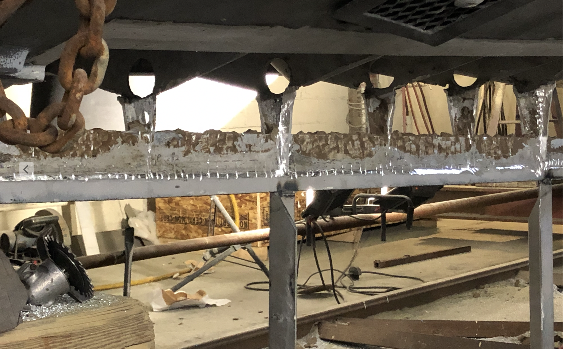

    Lowest portion of the tank. Suspect water in the fuel tank perhaps coupled with keel immersed in muck bottom. Perhaps some trash debris built up inside as well. I had this issue at similar location of black tank in ER between wet bilges. Result was a full rebuild of keel structure and plate replacement, full length of ER.
    be thorough.

    Dang!! That's quite an undertaking! How long had you owned her before finding that little treat? Do you have any pictures of that project? That would be neat to see how it was performed.

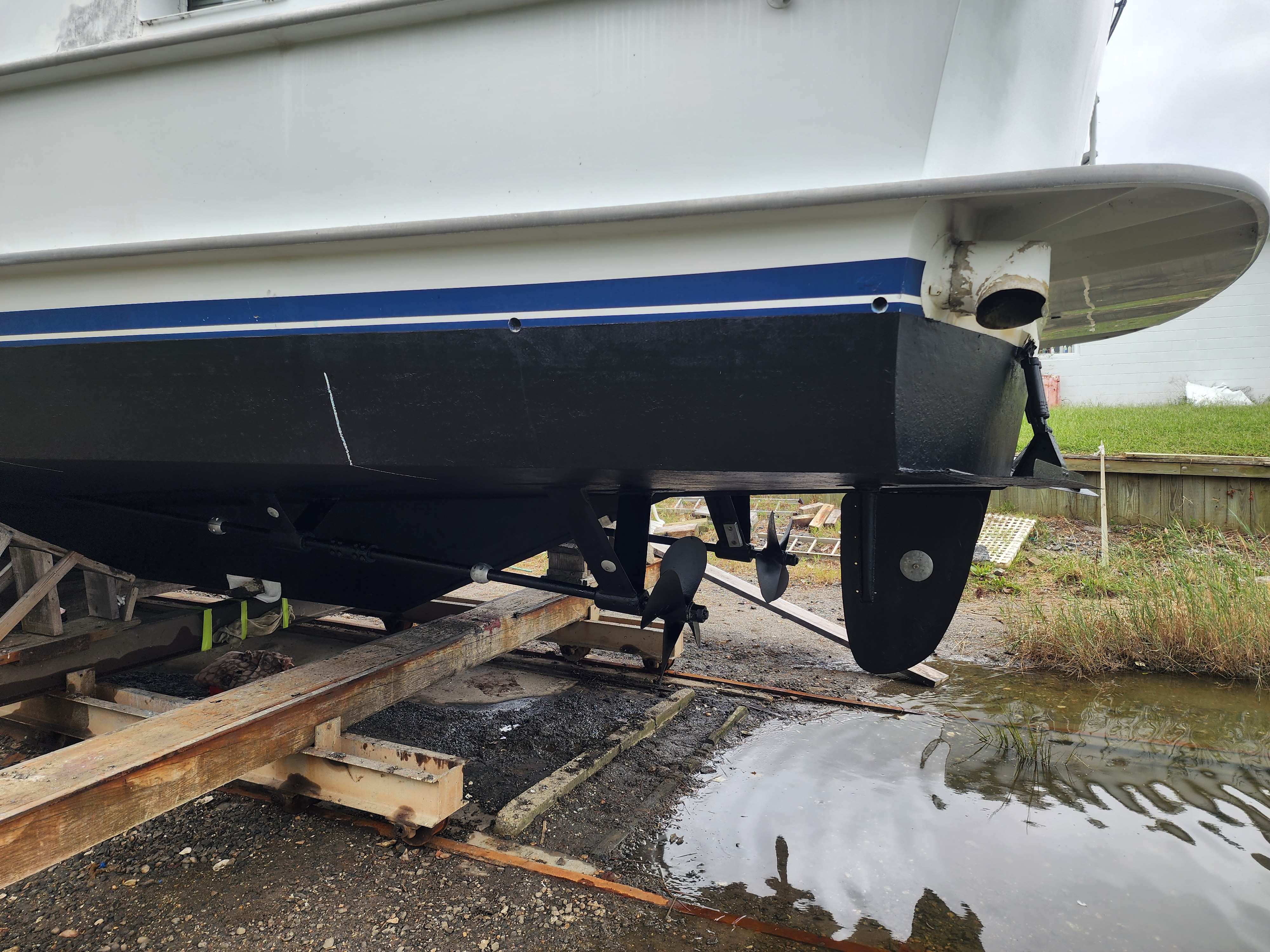

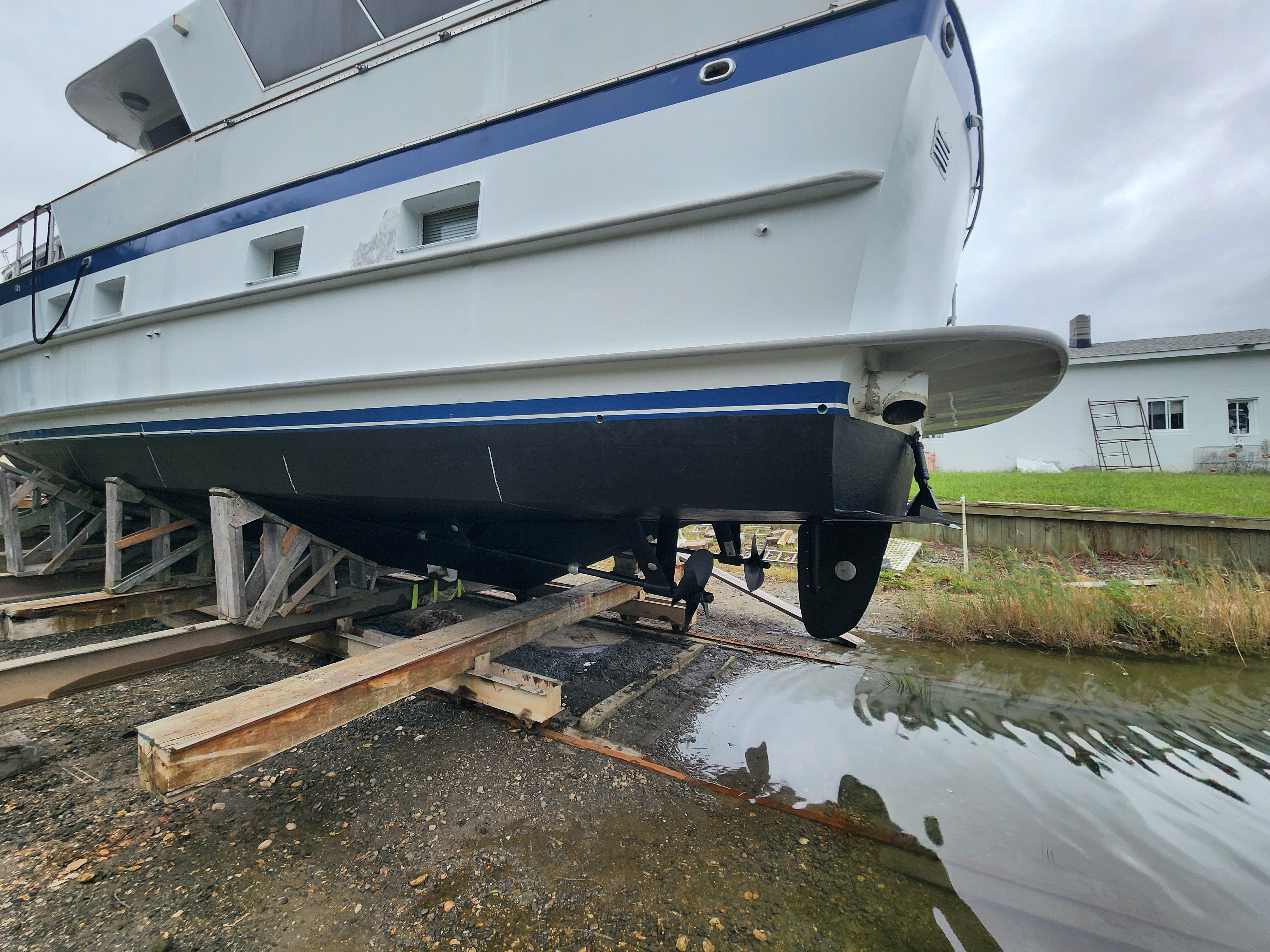

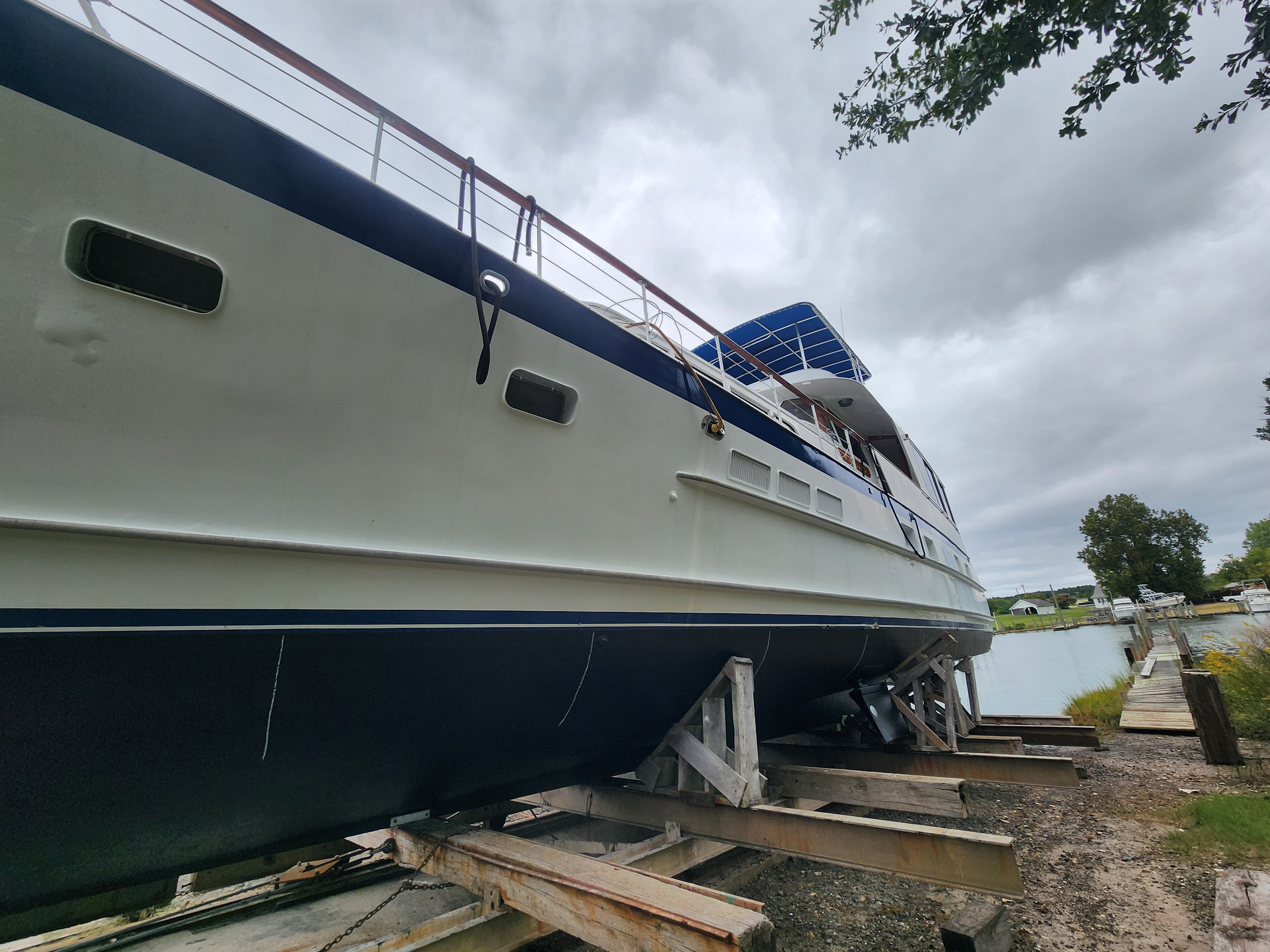

    She's been moved to another marina for haulout and repair. Messenger_creation_59DDF5FD-85B9-4676-91F3-2E8FCE1A0B8F.jpeg

    We went bulkhead to bulkhead in the ER, included the keel.
