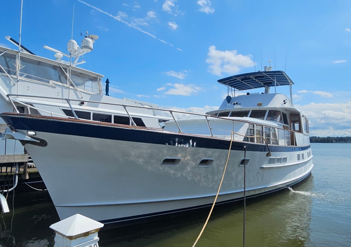

  9. TheSab
    TheSab New Member
    Nov 18, 2020
    6
    Central VA
  10. Capt Ralph
    14,527
  11. YachtForums
    20,942
    Good find, Ralph. Updated the thread title for better indexing.
