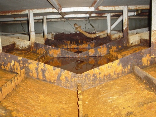

    2) There is no water pathways between the "ribs" of this boat that I can tell can anyone suggest what can be done to have the water accumulate in the lowest part of the forward half so a bilge pump can be more effectively used? (the water in the pictures are accumulated rainwater as this boat sat outside for several years without power and the only bilge pumps I have seen in my examination of the boat was in the engine compartment. In the CC commander I lived on for a bit there were water holes in the ribs but I can't find hide nor hair of any such thing on this one. The orange "rust" is a bacteria, it wipes off. (first thing I intend to do is pressure wash it with clorox!)

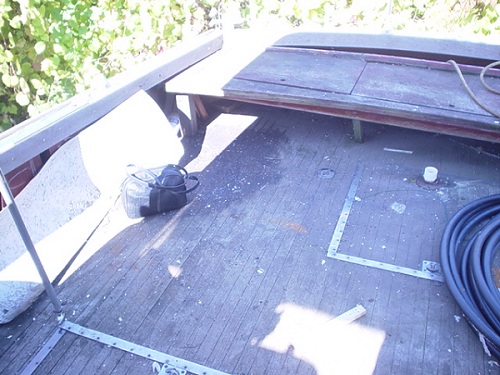

    3) The back deck was a quite a bit abused by rain and weathering. yet I could find not signs of a deck drain to the empty water off the decks. could someone tell me how there boats were designed to vent water? or was it supposed to be via bilge pump? Steel + water = rust and I am trying to avoid more than she already has.

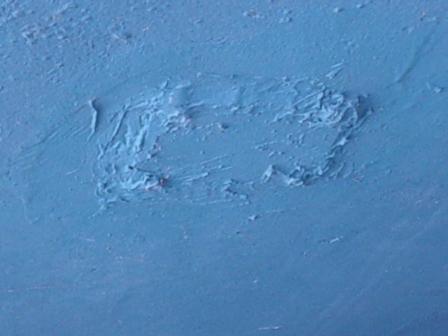

    4) There are some "questionable" patches on the port side of the hull. And the rear of the starboard side they are rough and don't seem like they are welded. (feels more like fiberglass) It is my intention to grind them off and weld a segment of plate there instead.

    On each side of the keel, there is an small opening to allow water to drain down between the ribs. They are probably blocked with crud and rust. What I do on my boat is clean them out with a screwdriver from time to time.
    On each of the aft corners of your deck should be a scupper drain to allow deck water to drain through a hose and out through the transom.

    Hmm, this rear deck had no signs of a scupper nor an outlet for the water nor any plumbing on the underside of the deck for them. The hull sides and transom are smooth without any through-hull fittings until you hit amidships and you have one for the bilge pumps. (I might not be good with terminology of what things are... but I know what the 45 commander had for water drainage and this puppy has nothing at all like that one did) It's not a problem to add this drainage, I just wasn't sure if I was missing something roamer specific. I'm just wondering if a past owner removed them because they weren't "pretty" in their teak deck.

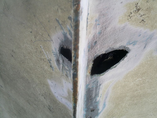

    The ribs are as shown in the picture... everyone I tested and looked at had no drain holes (which was about half of them) Now the stringers had them but not the ribs... I'm just wondering if someone in the past life of this boat decided to seal them or if it was actually not done on this vessel for some reason. I did take a pocket knife and poke at them trying to find a crud filled hole and had no luck with about five of the ribs in a row. They simply aren't there.
    So it wouldn't structurally harm the ribs if I drilled them?

    In the pix here, there could easily be small limber holes buried in the crud where the frames meet the keel. Are you saying that even in places where there is no crud and you can see the entire area where the frame meets the keel and hull, the frame welds are continuous in that area? If not, get rid of the crud and give it another look. On every other Roamer I've seen, Chris Craft didn't do something as stupid as forgetting the limber holes.

    The aft deck scuppers on my Roamer, which admittedly is a different model, are all the way aft and the outlet is on the transom in the vicinity of the fuel tank vents (i.e. up higher than the bilge pump discharge ports around the rest of the hull).

    On my Alum Roamer there was no coating in the deepest bilge, nor under the engines. I believe this is because the coating absorbs oil and /or water as Q240 says. I second his recommendation on painting those areas.
    Also - my roamer did NOT have limbers thru every frame, but always had a path to the lowest bilge area (thru the stiffeners).

    The limbers in the frames (thank you for letting me know proper terminology) might be just clogged solid with rust and I will only find them with hard work and cleaning. I was just surprised that I couldn't locate them by touch or probing with a pocket knife. When I get the boat home where I can work on it hopefully my fears for the bilge will ease.

    Art, your 58 doesn't have limber holes on either side of the keel plate at every frame? You sure that's not just some Black Beauty that hardened up? lol

    After you clear the limber holes you can get a very small diameter chain and run it thru all the limber holes loosely, when you get a clog you can work the chain back and forth to clear them. As far as the primer is concerend I would use a coal tar epoxy which won't breakdown with oil. The top coat is ,more than likey Silver Primocon which is a primer but I have seen and used it as a top coat. Most marine coating manufacturers have these paints.

    If I may expand on m2m's excellent suggestions...Leave the chain IN the limber holes. Fasten a spring to one end of the bilge in line with limber holes and fasten chain to it. To clear the limber holes, go to the unfastened end and just pull on the chain a few times allowing the spring to provide the return motion.
    Please correct me m2m if this is not something like you were suggesting.

    Seriously tho, YES every one of my frames has limbers at the keel - both sides. Of course I have a crash bulkhead and two watertight bulkheads that do not have limbers, but that's another story. I was speaking of the frames at the stiffeners. Not all those frame locations have limbers, but the stiffeners do. The real test of 'need' is watching the water flow. It MUST get to the keel; and it is here that it MUST go fore and aft.
    Also on the chain suggestion. My Grand Banks had the limber chains (brass)with the springs - great tool. They were made like an antique keychain - folded over links. Each link was made of thin sheet brass. I think brass chain would be OK on the steel boat, not on the Alum.

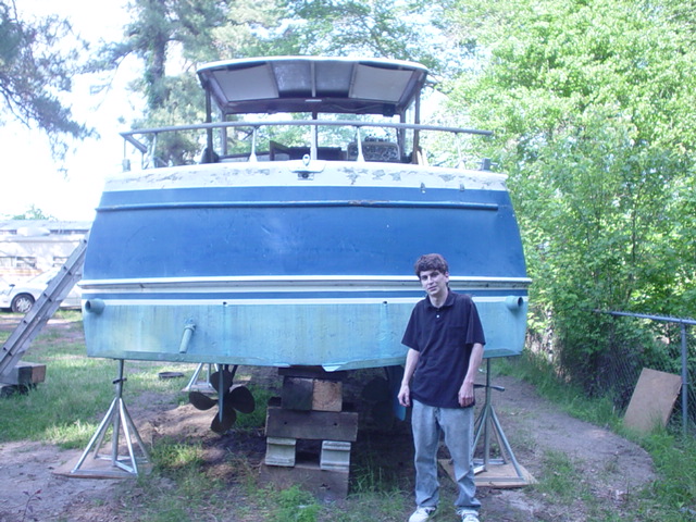

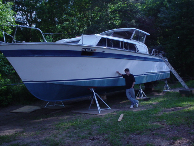

    Well I finally got the beastie home. Had problems getting it here and scrapped the idea for making my own trailer since neither of my trucks can pull it, it was the same cost for someone to haul it on my trailer as it was for hauling on theirs... so saved the expense of building a trailer for now. I have a good 12 months of work to do on this boat before it ever sees the water again anyway. After looking under the "patches" the previous owner did on this boat I have to remove them all and redo every single one of them right. From the looks of the cleaned up patches and the "rippling cracked paint" I found the shock I wasn't expecting. About 1/8 of the entire hull below the water line is coated with about 1/4 inch of body putty... like a bad car repair. The patches are 1/16 inch steel plates "glued" to the hull with body putty and screwed in place with self tapping screws. I have already removed two patches and found a total of 3 holes in the hull the size of quarters to 50 cent pieces. Not to mention about 3 dozen screwholes.
    As body putty retains and absorbs water the metal has surface rust below the areas I chipped out already. So far the metal cleans up beautifully and is smooth underneath. Although now I have to totally strip the hull inside out and out to make sure all the weak places are replaced... what I expected to be 8 square feet of repairs is turning into about 60 square feet. but once it is done it will be a boat my grand kids will inherit. I've been making a pictorial history of the work and problems I am finding on this boat so I will post more pics later...
    I did manage to find the limber holes in most places and have them cleared now... they were sealed with body putty of all things... The areas I couldn't see when I bought this boat as they were under water at the time are... sigh... depressing... but hey... if your gonna do something like this you want it last another 50 years. Or at least thats what I keep telling myself.
    Here is a couple of pics of my boat a few days after it arrived. Currently it has patches of primer on it where I have been sandblasting surface rust and priming it as I finish for the day. SC is very humid so I am not taking any risks on rust spreading.
