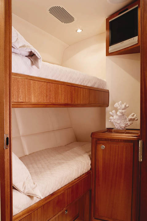

  1. The portside stateroom with it’s 6’6” headroom is where the crew or the gangly teenagers will bunk out. As in all the other staterooms, occupants can adjust their own air conditioning, watch TV or DVDs on the flatscreen, listen to CD & AM/FM tunes, and set their own alarm clock for the requisite oh-dark-thirty start for Serious Fishing. Storage is quite adequate in the hanging locker inboard or under the lower berth. No second-class quarters, the size of the ensuite head—just aft—rivals that of the VIP. Across the passageway is the laundry center.

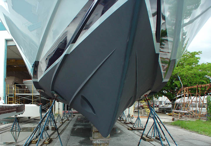

  4. Hull Bottom & Running Gear...
    The bow of this new 70 has more rake and has a noticeably finer entry when compared to this 57 (which has all the DNA of the venerable 54)—headseas will be met with a scalpel instead of the older steak knife. There are two strakes per side that run run aft about 40% and then cease. Twentyfive years ago, Bertram found that while lifting strakes offer dynamic lift (that old 31 had eight of ‘em), a penalty is paid in drag due to the additional wetted surface. The wide chine flats do the heavy lifting nowadays while the extra strakes add some spray-knocking capability as well as a certain styling element.

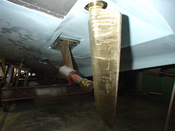

  5. Unlike others in the industry (See the review of the 77 Hatteras Convertible in YF), Bertram chose not to go with cavernous propeller pockets but, rather, with ‘scallops’. This helps lessen the draft but not at the extreme expense of large transmission ratios requiring massive umpteen-bladed propellers. The bronze rudder is notable for it’s very deep chord. Together, with the keel that runs all the way back to the transom, this Bertram should be capable of tracking ramrod- straight in the kinds of following seas that would make your socks roll up & down. The strut is the time-tested Bertram hardware and it’s palm (which is bolted through the hull) is fitted flush into a recess...

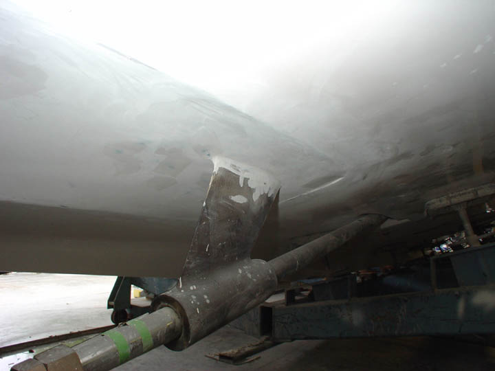

  6. ...and then the whole affair is nicely faired into the scallop resulting in very clean water flow.

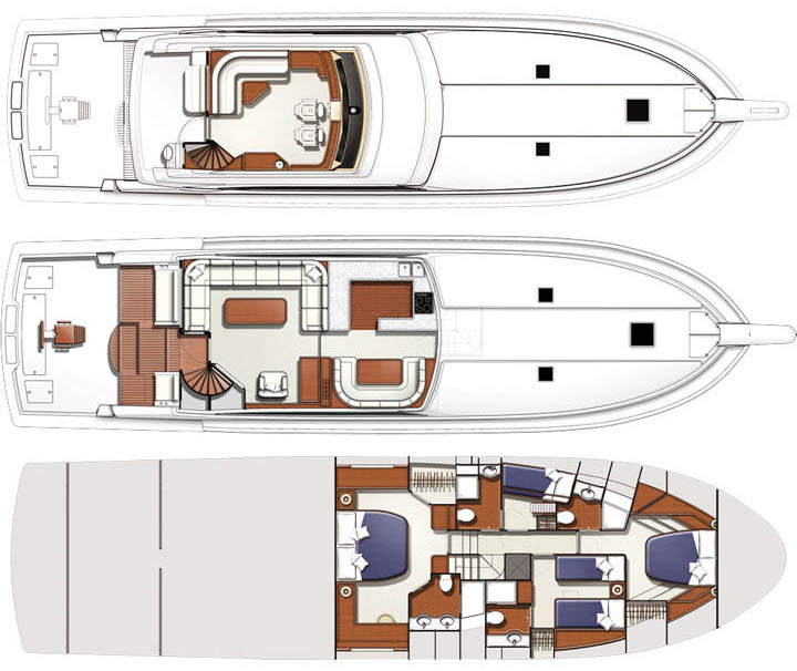

  8. Deck Plans: Top to Bottom...
    1. Bridge Deck
    2. Main Deck
    3. Accommodation Deck
