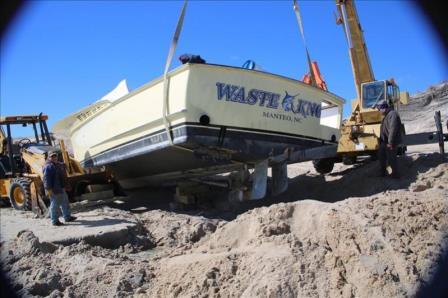

    I found this interesting pic of Waste Knot.
    The boat is the charter boat from Oregon Inlet that recently sunk after a suspected hull breach.
    Unless the photo is misleading, It appears that the boat is single engine with dual rudders.
    Although most traditional Convertible SFs are dual engines; I can understand the positives and negatives of a single engine.
    I do find the dual rudder design interesting and I have never seen dual rudders on a boat like this.

    I've never seen dual rudders either. Those Wanchese one off builders do a lot of strange things from time to time. My guess is the single rudder wasn't large enough without going deeper and they wanted to keep the draft down as much as possible so they went with two to hopefully have more rudder surface without rudder depth from the hull. This is purely speculation.

    Probably the majority of the charter boats up there have dual rudders Capt J, most private boats have twin engines so you wouldn't see dual rudders on a single usually. Helps a lot backing down on fish and there were a lot of them set up as "flanking" rudders where a second smaller rudder was added ahead of and slightly offset from the wheel, VERY interesting rudder linkage to make that work! Many of the old school guys could do slalom turns both directions in rewind, can't do that on most single engine boats!

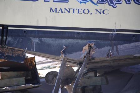

    It appears that the rudders were pushed through the bottom of the boat by touching bottom.

    Is that want brought her down, or is that collateral damage? I saw that damage, but didn't think it was sufficient to sink that boat, particularly if it was moving forward?

    looking at the picture, there it appears to be little or no damage on the wheel, shaft, or strut and the rudders look like they were pushed up.
    The pushed up appearance makes me think the rudders were pounded up in the surf landing after the hull breach.
    I think if the rudders caused the initial flooding there would be some bending from the forward impact and possibly at least a wheel blade bent back.
    All just speculation.

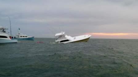

    Word is they hit a submerged container. One of the other charter boats attempted to tow them in until the cleats pulled. All made it off safely, thanks to the help of the other charter boats.

    thankfully we do not have many containers floating around in the LI Sound or BI Sound. Are there any telltale signs of a submerged container?
  13. Capt J
    14,435
    I do a lot of ocean miles every year, 10,000 or more per year and have for quite some time. I've only seen 1 floating container in all that time, so it's rare. That was about 20 years ago. BUT, usually you will see seaweed or other ocean junk floating around it. As the container usually is mostly submerged and the other stuff kind of forms a weed patch around it.

    In the last pic of the transom with the rudder sticking through it, the pieces of the transom/hull that are bent out look pretty thin to me.
