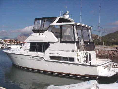

    Here's a pic of the vessel.
    I can't wait.

    I have the same boat without the cockpit. I've had my 355 for a year and love it. The sundeck is a little small for more than 2 people and my wife is on her 3rd attempt at arranging seating. It's a great layout for extended cruising. We just spent 13 days on ours and never felt crowded. Lots of storage for food and other dry goods in the V berth. I did some "remodeling" on the entertainment center to modernize it.

    I looked at a similar boat. Everything seems to be the same on the boat but when I saw this picture I realized it wasn't the same boat because on the one I looked at all of the enclosures are gone. The boat had been sitting in the water since 2001 with only one trip on it. Needs a lot of paint touchup and the hull had not been cleaned in years as the boat had not been used. When I looked at the boat, there was a surveyor there by the name of Todd and he had given a visual survey for someone else who was looking at it. The people decided that they didn't even want to go for a ride in the boat to test it. It would be a nice boat but needs a lot of work and I was also told that the Carvers get a lot of blisters. Then we talked to someone who went for a test drive on the boat and it was blowing a lot of black smoke out and the top speed was 17k and rpm only went up to 2200. That person is still interested in the boat but said there are no maintenance records and the log book only showed one trip out to an island. So the man said that he would really have to do some more research. I have since found a great deal on another Carver. Really like the style of it and we are enjoying the boat.
