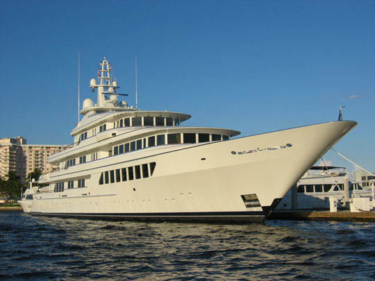

    The Utopia look, with an array of vertical windows curving around the face of each deck, has certainly become popular. Questions: Was Feadship the first with this style? If this style does "belong" to Feadship, and it can't be considered "Feadship classic", what label do we give it?

    Outside of the design of the Utopia's windows...For some reason, at times she looks top heavy and other times she does not. From some angles she looks well proportioned...from others she does not? How could we account for this?

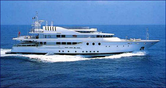

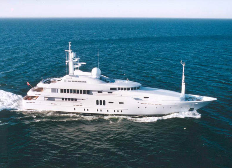

    A 1998 Palmer Johnson "La Baronessa" re-named "Frequency"...sitting somewhere in Turkey as far as I know, as a goverment property.

    Easy answer. Problem lies in the width of the channel to reach the sea from the shipyard, dramatically reducing the maximum beam of Utopia to the traditional 10.80m. Due to this also her price was Utopic. I wonder about the stability. And this answers also your angle problem. Side view-ok, front view-drama.

    To me she looks proud and regal. But, without the dramatic bow it would be a complete failure. All up, this is a classic statement in design and it does deserve a contextual 'anchor.' ...At the Maritime Museum.
    Architecturally, it reminds me of the 40's SoCal modernist movement. Robert Schlinder meets Admiralty. The key lines dramatize the fore-deck areas while the cabins play subtle little tricks of proportion. Add a few bold portholes, and it would make a superlative restaurant on Hollywood Blvd. (Valet parking, just $10.)
