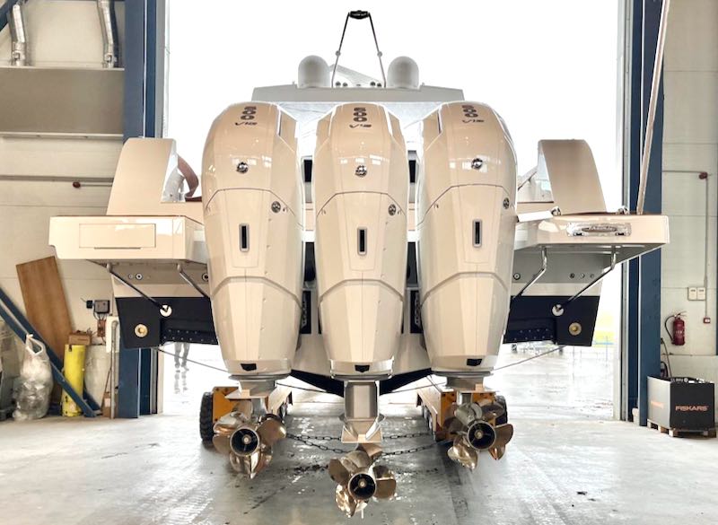

    Here you can see the interceptors recessed at the end of the shallow tunnels on the Delta 60 Open for outboards (52 knots)...
