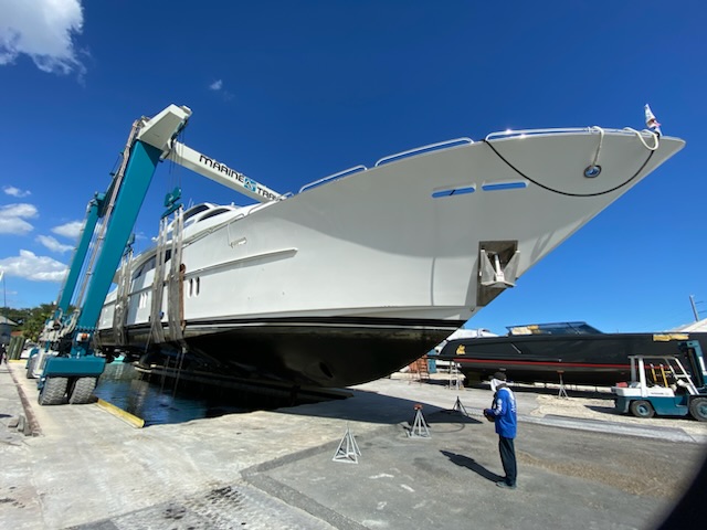

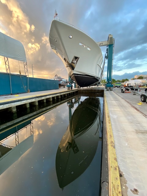

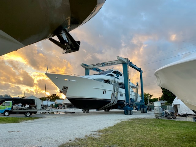

    this week we did the first haul out on the lazzara 116 I took over in May of last year. It was also the first time I used APEX marine on the Miami River and they were able to get us in and out in just 4 days. We hauled out Tuesday afternoon, blocked wed. Morning and by Thursday afternoon they had the two coats on bottom paint on.
    adding the second stage on the TNT lift took a little longer but we finished that Friday late afternoon and launched Saturday morning. This is the shortest yard time I ve ever seen.

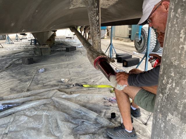

    I also had the wheels pulled to magnaflux the shafts, not wanting a repeat of the lost and retrieved prop incident back with the 84.
    I am really impressed by this yard although 116’ is pretty much as big as they can take since the canal is pretty tight, especially on one engine as we re rebuilding the starboard 16V2000. We had about 3’ to spare to turn in and out

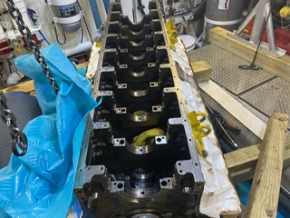

    No stern thruster, not needed. Hydraulic bow thruster which only yield about 40% thrust with only 1 hydraulic pump on the port plus a smallish PTO on one gen.
    the mains have close to 4000 hours but are 18 years old. We did the port engine last year after finding oil in the coolant and some elevated readings. Found bearing damage although the crankshaft was fine.
    On starboard We started getting traces of metal along with fuel residue in the oil samples. Then when they dropped the pan and inspected the crankshaft there was some damage incl rust, apparently from a raw water pump issue at some point in history. Bearings were pretty bad too.

  12. Pascal
    8,546
    Yes, port and bow thruster only. This is what the starboard engine looked like :)
    a stern thruster would have been nice to back up on one engine…. That s why I had the yard launch us bow out

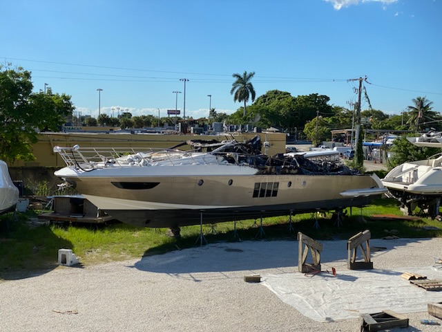

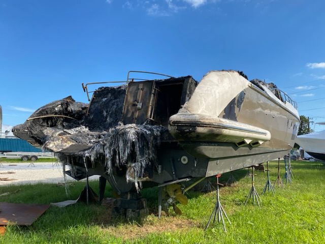

  19. Pascal
    8,546
    More of the burned Azimut. Magnafluxi the shafts
  20. Capt Ralph
    13,436
    Flux or dyed?
