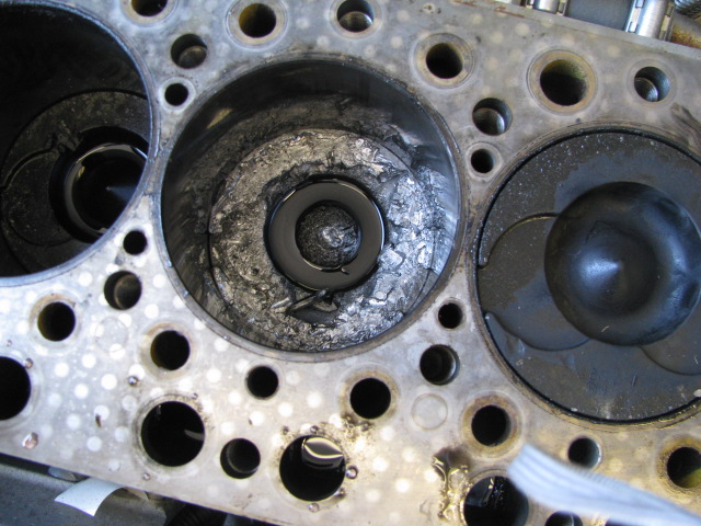

    I know there's another thread on this with posts the other day, but it didn't come up on a search. I believe Capt. J asked if they were sleeved. Unfortunately I now know the answer. No. IMG_2728.JPG

    NYCAP, You have posted a pic of a cylinder that has broken rings - your point is?

    Actually, I posted a picture of a cylinder of a Yanmar 6LY2A STP 440hp with 141 hrs. My boss also owns the one that came down the assemby line right behind this one.

    I have just experienced the exact same problem with a Yanmar 6LY2A STP 440 engine. Two valves ceased most likely due to a piece of the valve breaking away. Engine only has 760 hours. Any progress in getting Yanmar to own up to this defect?

    DK about Yanmar. They've never had a reputation for owning up to problems, but we've filed a claim under "latent defect". It's been determined that it was caused by a faulty valve guide. We recently authorized the insurance company to have metalugic testing done, and are waiting to see if they'll cover. I'd have to imagine if the tests come back showing a problem the insurance company would then have cause (and they have the resources) to persue a claim against Yanmar. Make a note to PM me in a few weeks and I'll let you know how things are progressing.

    I will continue to provide an update as my situation unfolds. I will be really interested in hearing the feedback from NYCAP123's claim on the same issue. The picture he posted of his cylinder is exactly the same as what mine looks like.
