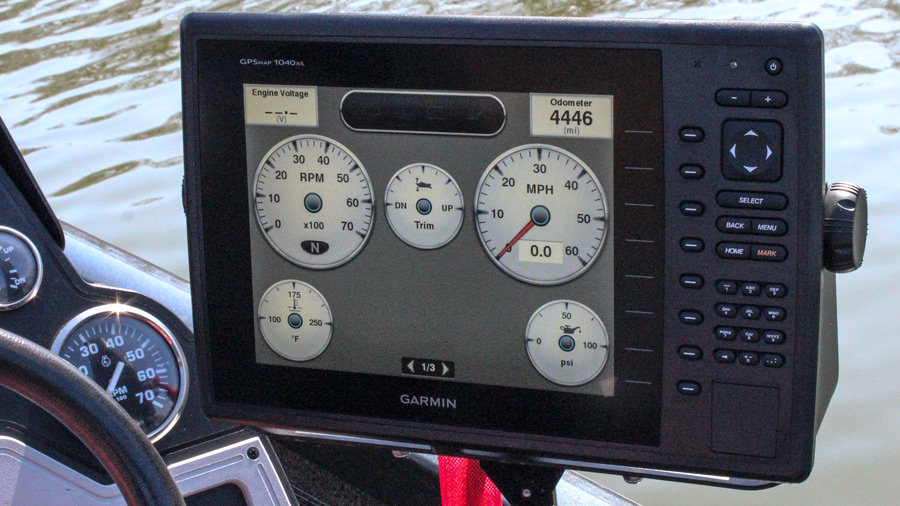

    Tried to hook up Yamaha to Garmin in the meantime as my Garmin 1040 has a "Gauge Page", but no cigar. Something is wrong downline.. image.jpeg

    They can't believe all 3 gauges went bad, but there is power coming to the gauges. The dealer found 1 gauge on the shelf and plugged it in on my boat.
    It works but not with full info.
    They are scratching their heads.
    Not my problem, full warranty but I was thinking Bimini this Friday, hopefully they get it sorted out before then. Not going across on partial panel.
