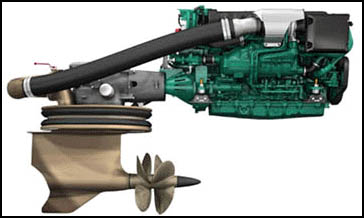

    The NEW IPS 750/850 Engine & Drive System...
  2. NEW 9-litre and 11-litre engines!

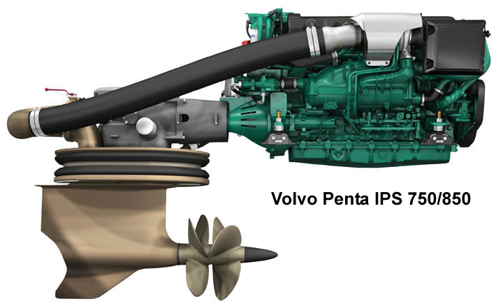

    The engine in the IPS-750 is the Volvo Penta 9-litre D9 marine diesel, which has been available for inboard shaft installation for three years now and has an output of 575 hp. The IPS-850 is powered by the all-new 11-litre D11 engine at 670 hp. Both engines share much of the same technology, including a unique twin-entry turbo which permits pulse charging. This is a technology that produces immense torque from low rpm's. In combination with the larger IPS drive units, Volvo has dramatically increased the range of boats that can adapt the IPS system... and this includes LOTS of yachts!
    NEW Larger Drive Units!

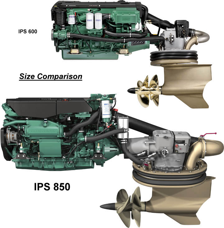

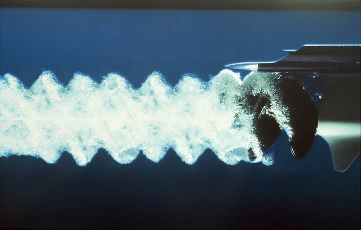

    The new larger engines produce more than twice the amount of torque, therefore Volvo Penta has developed an entirely new and significantly more powerful IPS drive unit, along with a new series of propellers. The new drive units have all the benefits that made the original IPS system so successful. The drive unit and propellers have been further refined with the help of advanced computer models together with comprehensive testing in a cavitation channel. The result is an integrated drive system with not only high efficiency, but also lowered fuel consumption.
    Side-by-Side Comparison - IPS600 to IPS850...

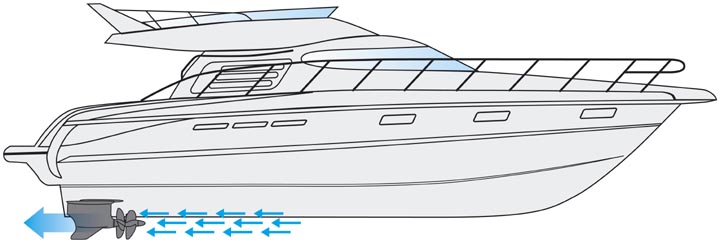

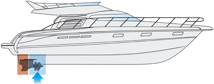

    The IPS drive system produces a TRUE zero-degree thrust line, unlike traditional shaft drive systems. This means the angle of thrust is directly parallel to the running surface of the hull. This is FAR more efficient than traditional shaft drives, which are angled down anywhere from 10 to 13 degrees, resulting in lift at the rear of the hull, thus pushing the bow down. This increases the wetted running surface of the hull. In addition, shaft drives also have an increased number of elements protruding beneath the bottom, including the shaft itself, the strut and the rudder. Each one of these appendages contribute to parasitic drag. In contrast, the pod-type drive is only one appendage!
  5. Forward vs. Rear Facing Props…
    Because thrust is under considerably higher pressure immediately after expulsion, positioning the props forward of the pod allows for lift to be generated toward the trailing edge of the hull's bottom, resulting in quicker acceleration and lower planing speeds. Another equally important factor is the leverage induced against the hull by the drive system. Remember Newton’s third law here… for every action, there is an equal and opposite reaction. Propellers generate thrust, but they also generate a huge amount of pressure in the form of leverage against the point of attachment. The resulting leverage induces positive trim to the bow. In essence, you have a system that is producing lift for the entire hull. A model of efficiency!

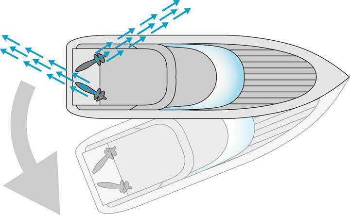

    And finally, a new mode of operation has been developed in cooperation with several Carolina-based Sportfish boat builders. When the sportfish mode is activated, the pods rotate to extreme angles, providing unparalleled vectored thrust that instantly swings a transom toward the fastest fish. The rotational force induced into the hull by the IPS pods is multiple times more powerful than traditional shaft and rudder systems. It's an entirely new function and it's attracted considerable attention. To say "Fish Fear This", is an understatement.
    Vectored Thrust...

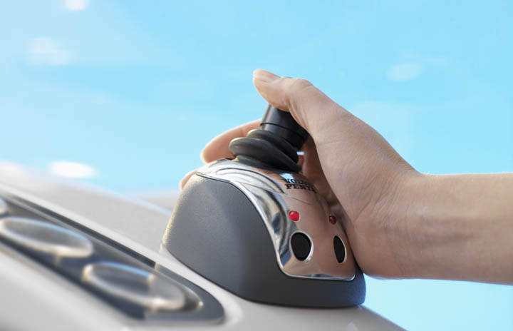

    Docking Stations: These remote joystick stations can be installed anywhere on the vessel, and in multiple locations, usually where a good line of sight is present for docking. No steering wheel required, but you may want to brush up on your Pac-Man skills.

    IPS Joystick...
