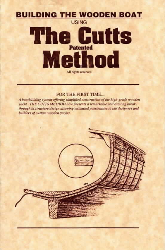

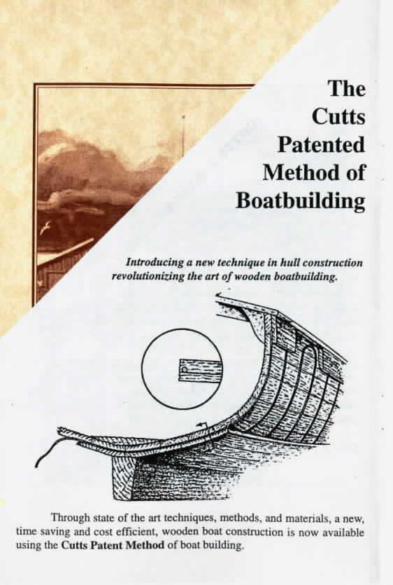

    This is an interesting twist to wooden boatbuilding and repairing.
    I ran across this old brochure I had from a very well respected old boatyard here on the Chesapeake Bay in Oxford, Maryland. Its been a number of years since I last visited this yard, but in my youth it always fasinated me.
    I shall just post the brochure as I scanned it. Enjoy

    Unique Wood Boatbuilding (and Repair) Method
    Since its a little slow on the forums this summer, and I happened to access this info again for someone else I thought I might give it a boost by to daylight again
    ...by the way the patent for this has expired...and possible with regrets the gentleman Mr Cutts may have as well.

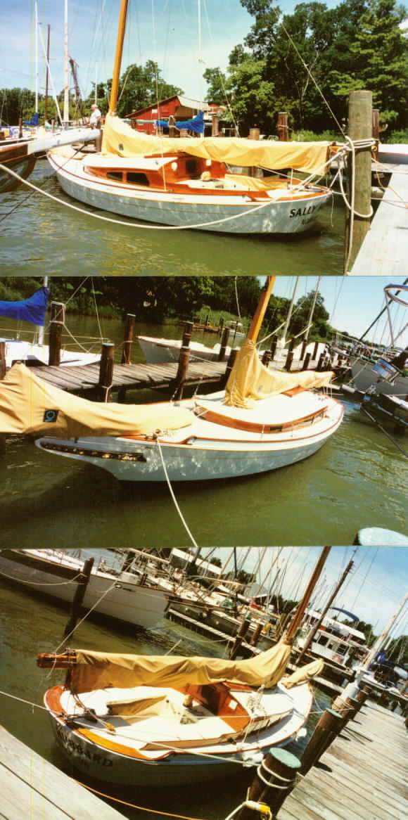

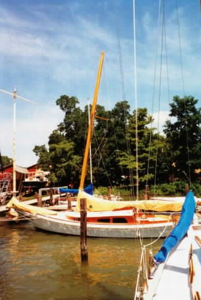

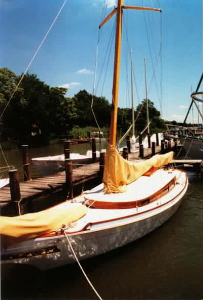

    I also have some pictures of a very pretty boat constructed in this method. She was a relatively smaller vessel with a very shallow draft for the Chesapeake Bay. So her rig was correspondingly shorter, and a bit more beam to give her stability.
    But what a pretty sheer & deckhouse line and clipper bow
