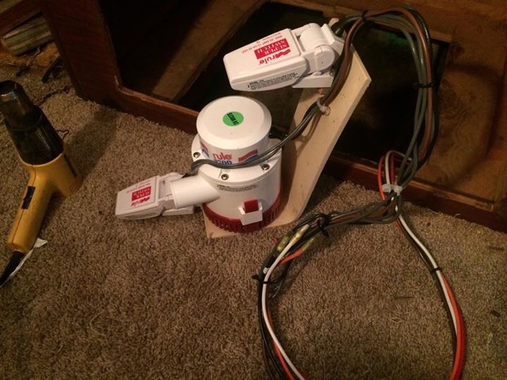

    Having spent so much time and effort along sometimes with bloody knuckles and cramped muscles, I have taken a different approach to the bilge pumps on my 53 Hatt which I am currently refitting
    Each pump (6 of them ) is mounted on a starboard bracket along with the float switch and the high water alarm switch. This way, the screw are easy to reach and the whole thing can be pulled for troubleshooting and part replacement
    Each set is powered by a 10ga harness color cused (5 wires total)
    The 6 bilge pumps and the 2 shower sumps are powered thru a sub panel with breakers, over ride switches and LEDs showing each pump status (ready, running, high water)
    This sub panel is fed from the main bank separately from the main panel and is visible from anywhwwre in the main saloon
    I will also add a repeater indicator panel at the FB helm
    I ahve seen way to many boats where the pump and high water alarms are hidden behind cabinetry or positioned where they are hard to see
