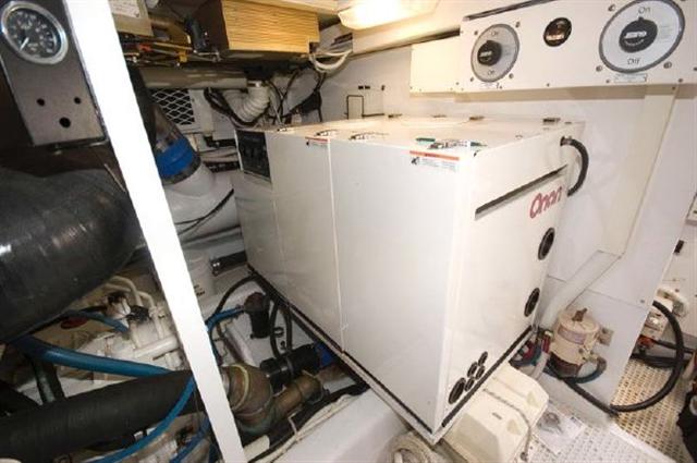

    Found this pic online of another 56. Should be your setup?
    Short term - this may sound a bit crazy but what about a heavy duty garbage\leaf bag. Fill it with the 4-5 gallons and let it draw from that to keep everything clean. Maybe a small strainer of some sort in the bag around the pickup to keep the bag from blocking?
    Long term, what about replacing the 90 elbow with a 3 way bronze valve? Then you can screw a host barb into the other opening and just divert to which pickup. Hard part may be finding the size since it looks like 2" or more. But this would make future years super easy.

    That pic shows how my setup is exactly.
    Hose and pipes are 3". Big.
    The soft bucket might work or a small garbage can that I can feed with a 5 gallon pail with fitting on the side. I wish they would give better options to winterize when they build them. I hate to try and dis assemble the plumbing. Not much room and after 10 years it won't come apart without a fight.

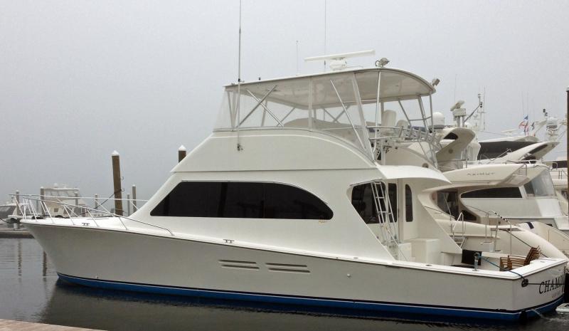

    At her home dock.

    Wow, she's gorgeous.
    I'm going to be the first to say, that I typically like to see OR's on a Sportfish, but she looks great without them as well. Beautiful!!!

    I think you're right, I like it without the riggers.

    Some Sportfish look completely "out of sync" without a Tower or OR's, but the proportions and lines of yours are "spot on". The last Post that I saw was a mid-90's and much smaller, so to see a 2003 look that good is a nice treat!
