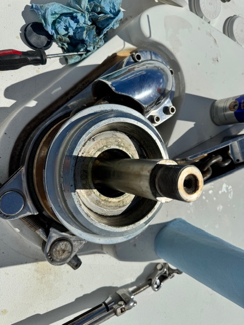

    One of the lessons to be learned from the beached Viking is that you need to be sure your anchor can free fall if needed and that your crew knows how to do it. Especially important is to release any mechanical locks which may otherwise jam if the clutch and brake are released before the hook, cable etc.
    well… surprise surprise when we tried this morning, our 400 pounder wouldn’t free fall…
    maxwell 4500 series
    so, we pulled the top and the rope capstan and discovered the clutch was seized into the chain gipsy. Took a while to free it. Ended up jamming the anchor against its stops, keeping the hydraulic pressure on briefly while helping it by hitting the clutch with a bar and a hammer.
    not something you want to do in an emergency. Lesson learned, we re now going to use the free fall once in a while to make sure it works.
    second lesson: make sure the clutch release tool, on our case a long heavy alum bar, is easily accessible and not buried under lines and fenders…

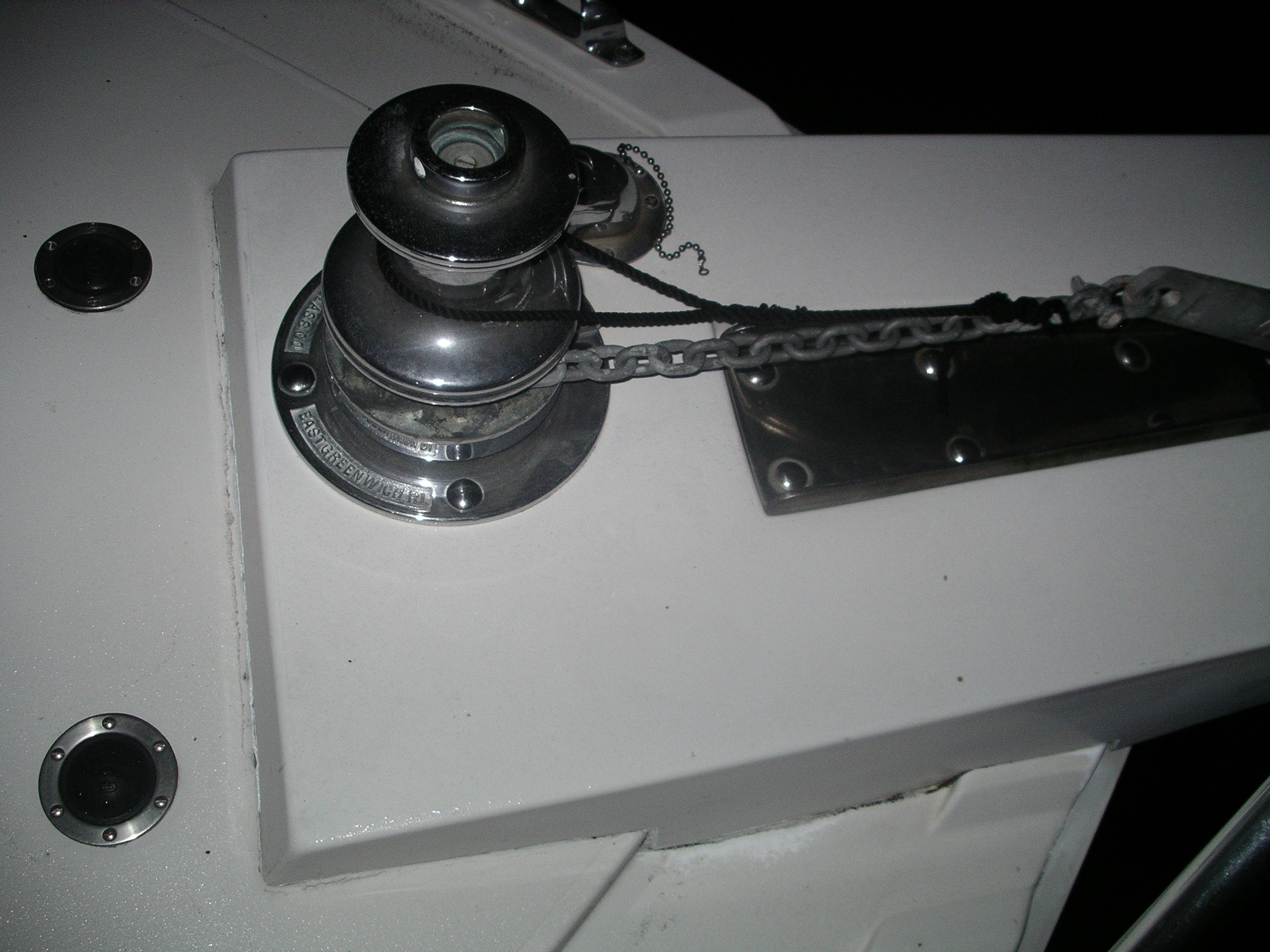

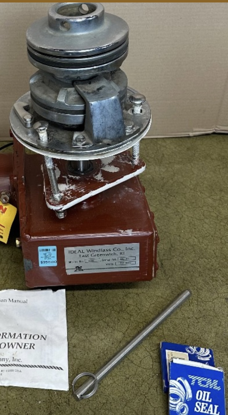

    The Ideal windless is just a straight piece of straight stock long enough to go through both hole and give you some leverage. Gonna have to try mine which is indeed in a step locker and see if it really works. We always power down as we never anchor in more than 20-22 feet of water mostly less.

    Found picture on internet. Hope that helps

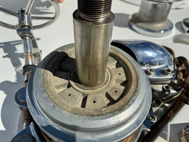

    Handle arrived. Seven turns and the very top portion unscrews and comes off but no evidence of either free fall or anything else as a result. Got too dark out so will explore again tomorrow.
  20. Pascal
    8,544
    You re going to pull the line capstan to pull and line the clutch
