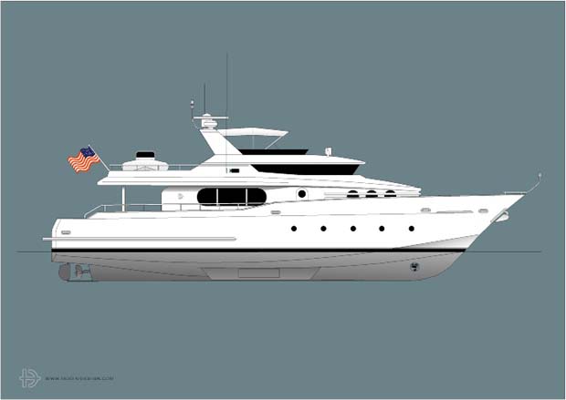

    Your idea is in essence what I had in the old design I just found. The moving part is also attached to a bar connecting the two fixed keels as a protection and to make all of it more stable. I think it should work really well if installed at the right positions...

    Lars,I can see in the picture that it shows the positioning of the keels and that will depend on the hull shape and length of the vessel.

    in the image the passive appear to run a little deeper than the active, is that what you would suggest? My idea wasn't to encase them the way you have but I could see how this would work well. They passive I'd planned to be about half as deep as the active.
    Would you keep the passive straight or curve them to the shape of the hull?

    These bilge keels are angled outwards about 30 degrees from the centre and must remain straight when you look at them from the front so they don´t act as rudders. As you probably know it can be hard enough to get your rudder(s) or rather the autopilote and the active stabilizers to work nicely together.
    The moving fin is enclosed to not catch fishing gear so easy and this whole setup is also fine where you want to dock at ebbtide.
    The shaft for the fin is a little forward, off centered.
    For a pure yacht such as yours, I think bilge keels half as deep as your fins is a good start. It will not be so expensive to modify later if you so wish.

    When implementing both passive and active stabilization methods into one hull, wouldn't the passive effectively reduce the effectiveness of the active stabilization? Sure, I see that it could/would help as well because the active likely wouldn't have to work as hard because the boat wouldn't roll as easily, but at the same time it'd have to work harder to fight against the passive?
    Point being, it seems to me you would need to carefully calculate the size and effectiveness of the passive/active combo so as not to eliminate the effectiveness of one or the other. Maybe I'm wrong and they pretty much always work together, helping each other out. Thoughts?
    On a side note, I like the enclosure of the active stabilizers, if nothing else, as a way to protect the fin from getting ripped off if the captain were to, uh, get off course. :)

    You are right Bill and this is also what I said in post nr 7. This combination has to be tested out carefully, but on small and not too fast yachts I think they can be good since the yacht will maintain a pretty straight course which isn´t always the case with the active fins. Especially in following seas they can have problems and sometimes cause more rolling than if you shut them down. This has to do with how you trim the autopilot so the rudder speed and angle doesn´t accellerate the rolling...
