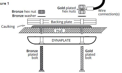

    Could it be the ground plates..?

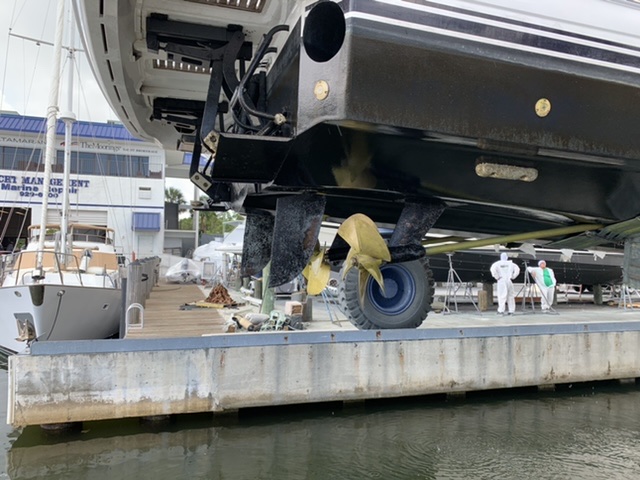

    It's more than 2 boats. No, Man's and Cat's. They''re the only 2 zincs on the entire boat, aside from bow thruster. I'll try to find a picture and post it.

    The boat in the Picture is a 2018 62' Princess with Cat C 12.9's (but that is a Fiat/Ivesco motor). Their 55' and 62' with Mans also have the same anode position and only other anodes are on the swim platform. A 2019 66' Sunseeker with 1200 MAN's is the same way except those are mounted right in the center between the props. Everything in the boat is bonded to these 2 anodes from both manufacturers, except the swim platforms have zincs.
    The 62's top out at 32 knots +/- and the 66' around the same speed.

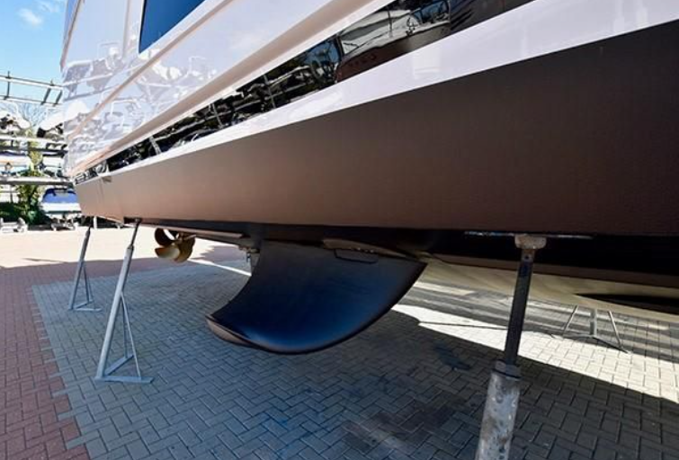

    Dana Point, Ca
    Would venture to say the loss of speed issue is less of a concern when they are fitted with stabilizers like this 2019 57' Sunseeker Predator:
