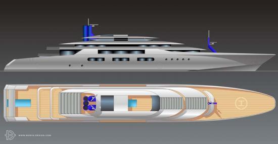

  8. AMG
    5,380
    One reason to have folding masts is that the fore deck can be used for helicopter landing or as an emergency pickup area.
    On the Triple Bling design I made a sculptural mast to free up the space...

  10. discokachina
    discokachina Senior Member
    Mar 21, 2010
    1,287
    Sculptural Masts Look Fantastic!
    Yes, a "designed" mast such as on Triple Bling looks like it is a well thought out part of an overall concept that adds to the beauty of the whole yacht.
    Much better than taking a pole, sticking it on the front of the vessel and painting it black to try and hide it, which may aid the crew, but does not add to the asthetic of an otherwise appealing design:)

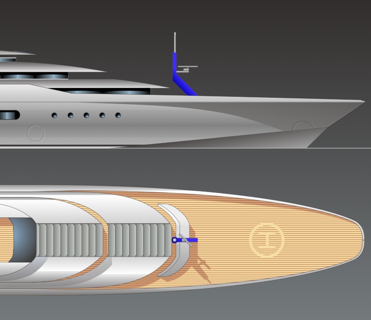

  13. Old Phart
    Old Phart Senior Member
    Mar 14, 2011
    1,329
    I dunno
    Call me crazy; but I'm not too crazy about the forward radar location.
  14. nilo
    nilo Senior Member
    Feb 7, 2005
    681
    Istanbul
    forward radar position
    well, i cannot specifically comment for this design; but most of the very large commercial cruise ships or container carriers have a radar in the forward position. this is due to the fact that they want to be able to see the immediate vicinity in front of the bow..
  15. AMG
    5,380
    On a 140 m (460 feet) yacht like this, you sometimes would like to have a close range radar in addition to the two main radars (working on different bands). The beam is not affecting any people behind the radar.
