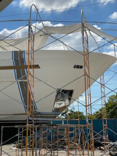

    I ve seen this on a number of Italian and maybe Turkish boats: a bow section added on to the hull instead of having a one piece structure.
    I can see the benefits of a watertight forward bulkhead but it could be done with a one piece hull. I v even told it was done to keep either length or tonnage under a certain limit.
    there is newish San Lorenzo next to us in the yard which is getting a nose job after cracks developed inside the assembly. They re grinding the paint, gel coat etc and will glass the seam. I bet the owner isn’t too happy

    On second thought, hang on a minute, are you sure of the reason for that job?
    I find it a bit hard to buy the suggestion that the hull developed cracks along the nose cone joint, for 2 reasons:
    First, Sanlorenzo (one word BTW, not two) does use the nose cone trick, but the final result is extremely solid, and I never heard of cracks along that joint before, no matter how bad the sea conditions encountered.
    Second (and more crucially, since I guess you might think my previous point is just biased by patriotism :)), there are strict rules on whether these nose cones can be considered just as "attachments" or not: in a nutshell, the boat must be fully seaworthy without them.
    But in the case of the photo you posted, I don't think that such nose cone could be considered as an attachment, because without it the boat would lose its anchors.
    I am attaching another example of a nose cone specifically designed as an attachment, for going round the 24m rule.
    The difference doesn't need any explanations.
    Call me suspicious if you wish, but I smell an accident where the boat simply hit something, and they are airing the story of structural cracks because they prefer to blame the builder rather than whoever was at the helm... ;)

  7. Pascal
    8,546
    Since we own three Alfa Romeos… you can be sure I am not biased against Italian products :).
    the explanation about the cracks came from the yard manager himself and I have no reason to doubt his explanation. There are no signs of the boat having hit anything. Not a scratch on her hull.

    Whoa, three ARs? How come you didn't get a Pershing instead of a Hatt? :D
    Of course I also have no reason to doubt of a yard manager that I don't even know.
    Still, the above joint doesn't look to me as the original nose cone split - but I might be wrong.
    I'll try to find out, can you confirm the exact SL model?

    OK folks, I just had a quick chat with someone who knows these rules in general, and also SL construction specifically, like the back of his hand.
    As a result, I must stand corrected: the joint in Pascal photo above is indeed located where the nose cone is attached to the rest of the hull in that boat.

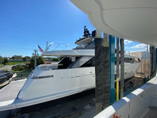

    Here she is
  11. Pascal
    8,546
    No this is fixed. Plus the sections around the keel wouldn’t provide any lift anyway.

    The boat pictured is an SL96A. It’s yard number 741, approx 2020/21 boat. Called gatsby now, previously creed, and previously to that ninipop xl. Based Florida since new.
    I’m reasonably familiar with this series of boat - I have a new one in build currently. YF occasional poster Ace also owns one.

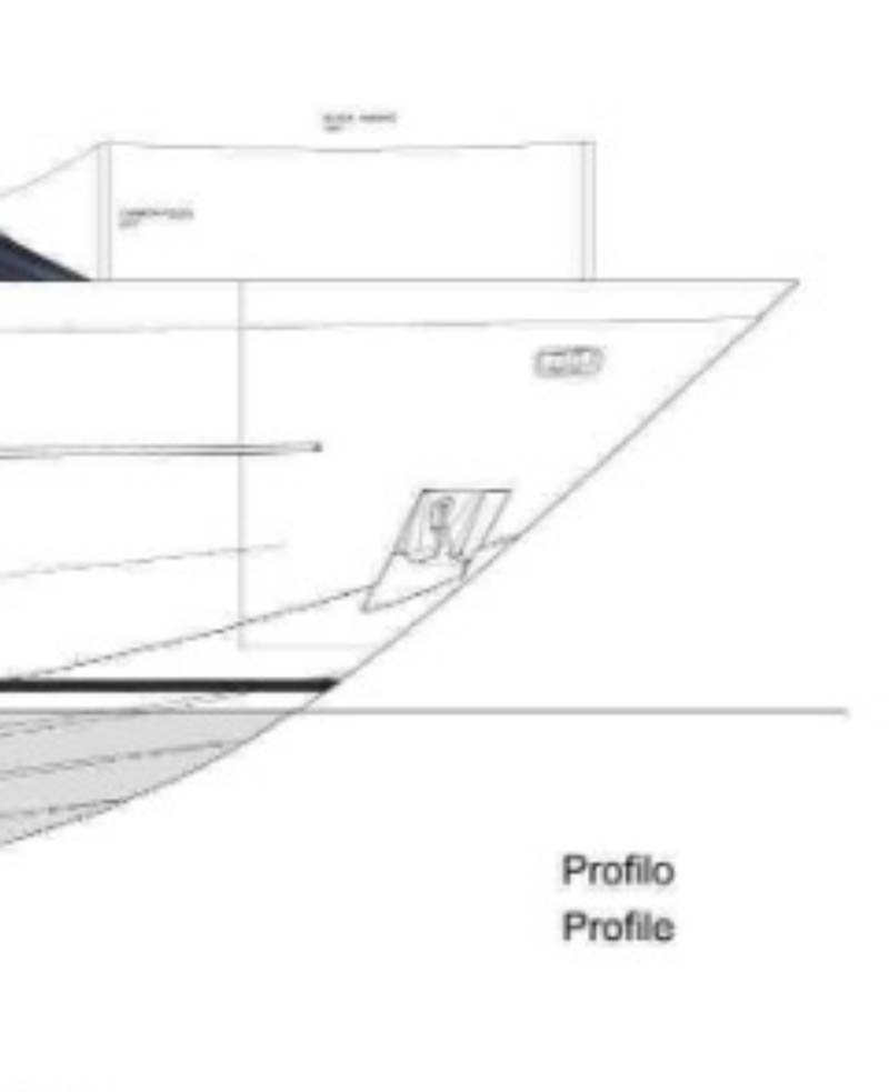

    The removable nose is not to keep the boat under 24m LLL. A quick look at the profile line drawings tells you that she is under 24m LLL even if the nose were not separate. Its purpose is a European thing - it is to keep the boat under 24m LH as measured according to iso 8666. LLL and LH are different things.
    Keeping a boat under 24m LH serves two European purposes. First, under many states including the red ensign states there is an exemption from many regulatory rules relating to equipment on board is the boat is “CE marked” (or the new Uk version of CE marking) and that in turn requires being under 24 m LH. The so called RCD rules in Europe that govern CE marking are based on LH not LLL. Second, some ( a minority) European countries require an upgraded captain’s licence at 24m LH, even though most only require that at 24m LLL.
    I have no idea why that particular SL96A is having work done around the nose cone joint. I really struggle to believe it’s any kind of cracking or fault, because these boats are made so strongly, and also the flange joint between the two parts is immensely strong. I have seen that up close. Also the nose cone piece sits on a “ shelf” on the main hull. And this is one of the best yacht builders on the planet. I would guess the owner of this Florida is doing it purely for aesthetics - to get rid of the visible joint, by laminating then gel coating over it. Normally, the joint is pretty visible not just on Sanlorenzos but on all European boats that have removable nose cones.

    The interceptor plate is standard fit on all SL96A ( about 20 hulls so far). Not aftermarket. It usually projects about 3/4 inch, but this is adjustable (a little) because the bolt holes are slotted. Obviously makes for a spoiler effect to create a clean break of the flow, like on trunk of a car, and I suppose makes some lift. This boat doesn’t suffer from its rear “sinking into a hole” when in planing mode - plenty internet pictures and a Northrop Johnson YouTube ( of Ace’s boat) prove that. I agree the vertical parts make drag and I might cut them off on my boat.
