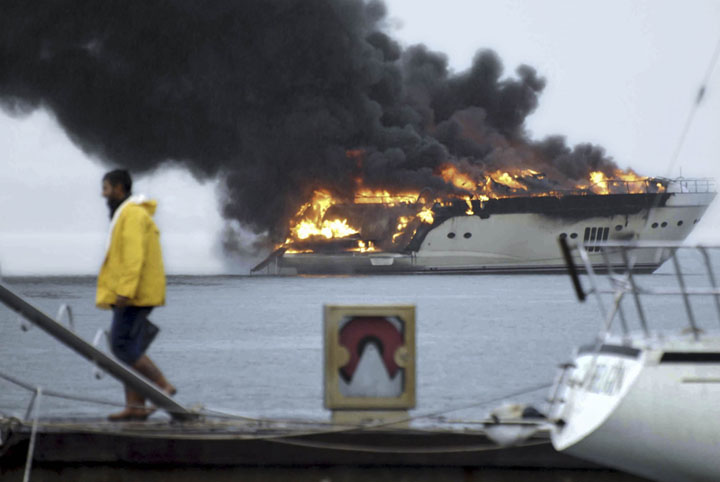

    Interesting article. The best insurance money can buy is top quality maintenance and upkeep. Then you have insurance on the off chance.
    Even some with plenty of funds are willing to spend them purchasing a boat, but not so much for crew and for maintenance. They encourage doing things the cheapest way over doing them right.

    From what I've seen, at least half the blame is from the Marina electric now being old and not supplying enough electric down the docks to handle the demand. I can think of a handful of marina's where you never see more than 210 volts..... some of those marina's have also had several yacht fires. The same size yachts are not using more electricity with more systems on them than most older ones. I just ran 2 59' Searays for examply that had 2 50 amp shorecords and needed both cords if using most of the boat's systems (for example). 5 years ago it was super rare to ever see a 59' yacht with more than a 50 amp service.

    210 Volts is a luxury. In the peak of summer, in our local marina I have observed voltages as low as 180 VAC and currents as high as 100A when they should not be exceeding 60A. This occurs when operating heavy AC loads on board the yachts such as air condition units. I have personally seen a few air condition PCBs and capacitors simply catch fire as a result of the exceeded load which could have led to disasters.
