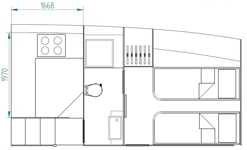

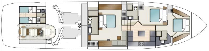

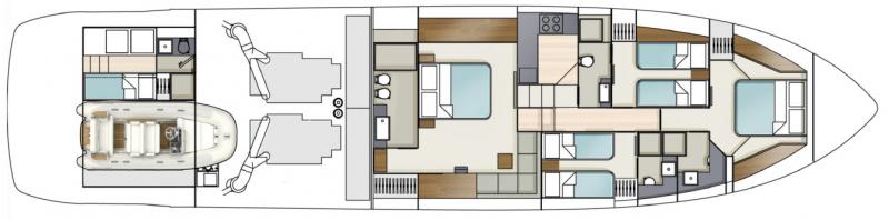

    Gentlemen, below are two options for the lower deck layout of a 75ft yacht. One has a 3 cabin layout with a large galley and the second a 4 cabin layout with a smaller galley. The 3rd image shows the galley dimensions in the 4 cabin lower deck option.
    Which layout do you prefer and why?
    Thank you for your input.

    If the planned usage were charter, then would recommend 4 versus 3 stateroom floor plan.

    For a 75 ft fast boat in the Med (Charter ?), I would go for the 4 Cabin version. The maximum a pantry/galley on fast boats is used here, is for snacks or breakfast. For dinner everybody makes reservations at the restaurants. Having said that, for the Med, the small galley would be fine but I do not know your circumstances in the Red Sea.

    I would go with the 4 stateroom layout. If you have a BBQ Gril on the deck above you could get plenty of cooking done. The only thing that I see being a problem is refrigeration.

    You could go for the 4 bedroom option and eliminate one of the bathrooms, have 2 bedrooms share one bathroom with access from the hallway.

    I personally would prefer the 3 cabin layout. It would lend itself better to a casual environment. That is unless you NEED the extra space
    And as Pascal says, people like to hang around in kitchens more these days.

    I like the 3 stateroom layout with the larger galley. Depending upon the configuration of the guests aboard, that side stateroom may be more useable with twin berths that could perhaps be convertible to a king, instead of the dedicated queen berth. Looks like an exciting project.

    It's tricky. If you are often cruising with friends, I would prefer the 4 bedroom layout. If I want to cook by myself I want a large galley. I think the large galley layout makes it not so cramped like another cabin on that side and a bit more "airier".
    Which unit of measurement is used in the 3rd picture? Centimeter?

    I like the 4 SR layout due to being able to accomodate more people. If you are looking for a great meal, there are so many places to pull in and break up the time between "being on" and "being off" the boat. I've noticed that the owners of Yachts in this size range tend to like to arrive at a marina / restaurant on the Yacht, then go in and eat / drink / socialize, then get back on the Yacht and head out. I enjoy this too as a Captain because it gives me a little time to "unwind" from the day and sit back and relax for a while. (Provided that the owners want me to join them for dinner).

    The units are mm. The dimensions are 1.97m x 1.66m

    Thanks again for all the responses and advice. It is a difficult decision but I think I will choose the 3 cabin layout and go for the large galley. The large galley will look elegant and will provide more comfortable and open space in the lower deck.
