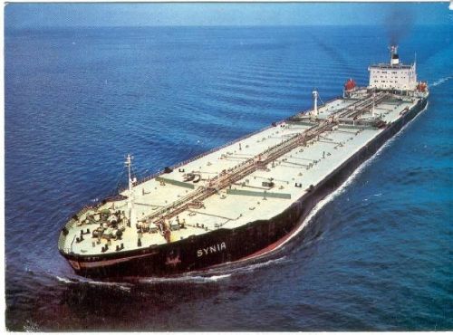

    1,000’ length. 200’ beam. Around 225,000 gross tons. And stabilized, of course.
  5. Norseman
    Norseman Senior Member
    Feb 24, 2005
    3,110
    You are describing one of the ships in my Sea Service Book: 1,000', 228,000 tons.
    Stable as a rock rounding the Horn with a full load of crude. Should be no problem cruising to the Bahamas, or even the Caribbean.:D

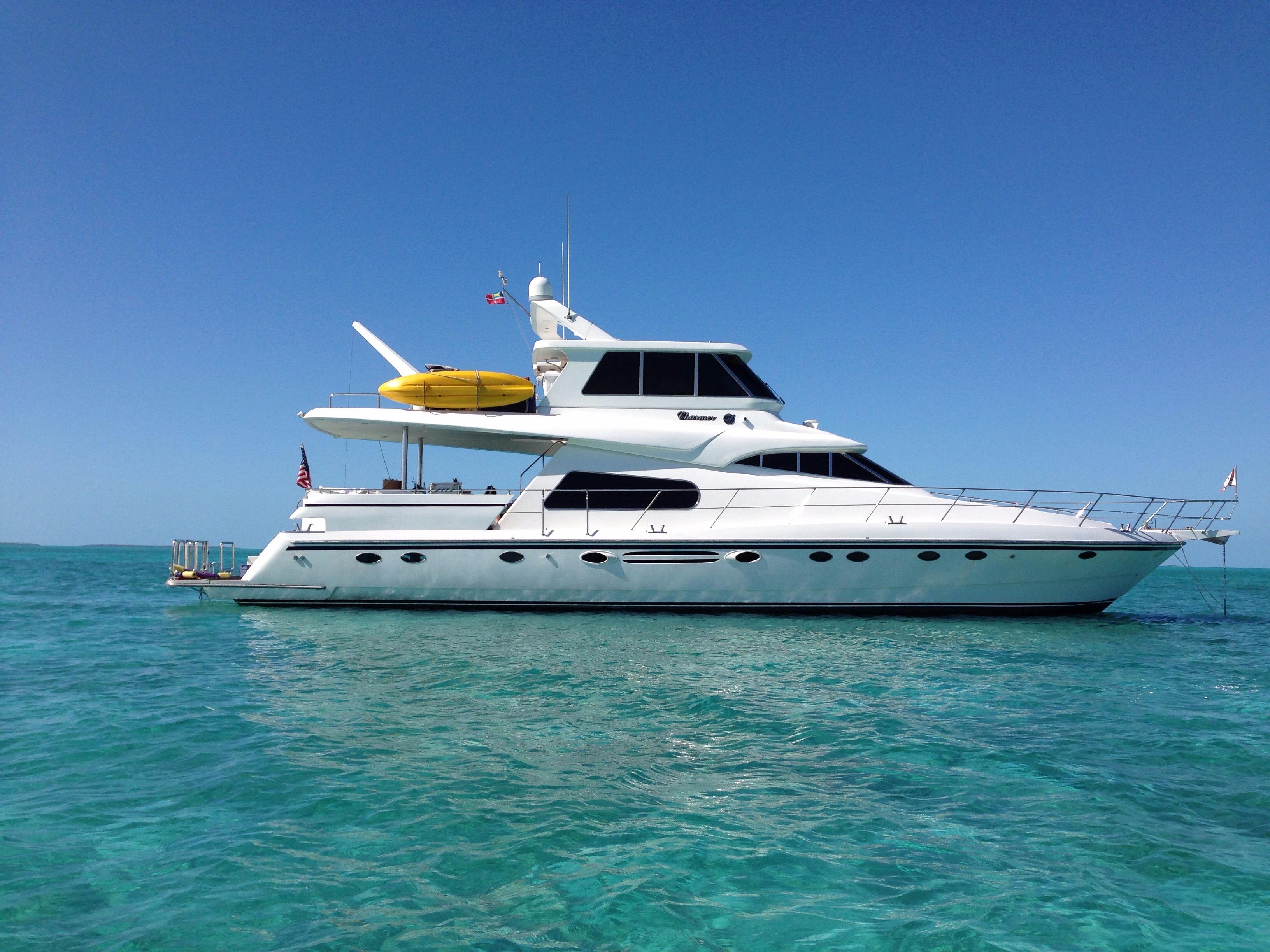

    I ran a Johnson 70' Sky lounge as well, almost 20 years ago.
    Yes, it slammed like it had a flat bottom, but fast: Electronic MAN's 1,350 hp.
    The Owner always wanted to go flat out, 29 knots but we never did the Bahamas, only the Keys on the outside. DAE766EE-49E4-4F94-BB2D-2034AC986543.jpeg

  13. Pascal
    8,546
    That’s the one I ran… Charmer. I see the name on the side of the skylounge. I made these with black lexan and silver graphic. :)

    Yup, I just picked the photo from the internet, couldn't find a pic of the Big Johnson I was running.:cool:
    The name was "By The Way", it had a strange option: Isinglass for flybridge windshields, hence no windshield wipers.
    After a cruise at full bore from Fort Lauderdale to Ocean Reef the isinglass was covered in salt, had to send the owner down to the foredeck with a hose to rinse of the "windshield".
