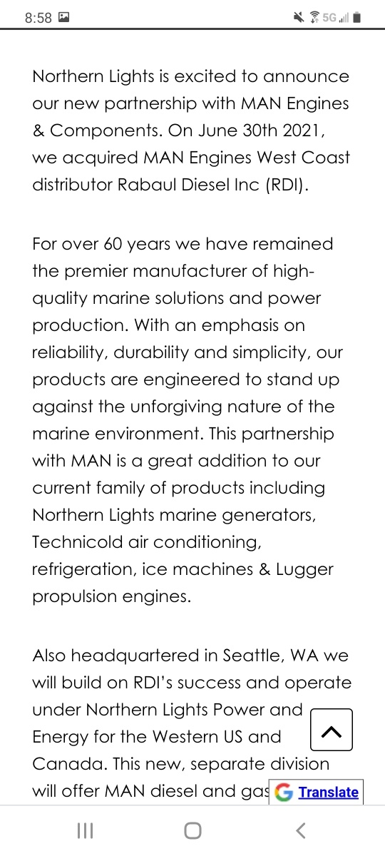

  16. CaboFly
    CaboFly Member
    Aug 24, 2018
    269
    Seattle
    Ironic timing. TBD if this ends up being a positive or not for the owner operator like myself. I have had fantastic support from RDI the last 4 years of ownership.
  17. DOCKMASTER
    DOCKMASTER Senior Member
    Feb 26, 2012
    1,496
    Ketchikan, Alaska
    Northern Lights is great to work with.
    And I agree with your points on the gap between the C18 and C32. I really wanted to add some hp when I did my repower but the C32's are just too big. I could have physically shoe horned them in but future service would be a nightmare. And as it turns out, I'm seeing better performance than expected from C18's so it turned out good for me.
