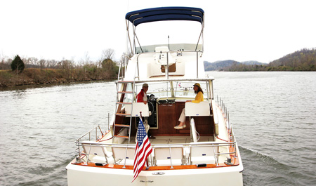

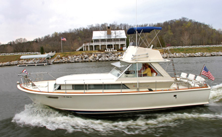

    I'm very strong on varnish, yes I know it's a maintenance issue but it just looks stunning when it's done right. I've known people who have painted their teak rails and trim polyurethane white, just to avoid the maintenance, and I think that's missing the boat when it comes to yachting. Yachting should suggest the finer things of life, and that includes sparkling brightwork, IMHO.
    In any case those who care to refinish their teak, or have it professionally refinished for them, should look at my files on the subject. My varnish job is now 7 years old, and it was good enough to publish in Motor Boating Magazine in the June Issue (Labor of Love) and the photos below show the teak, even on a cloudy day (photos were done on March 31, 2006).
