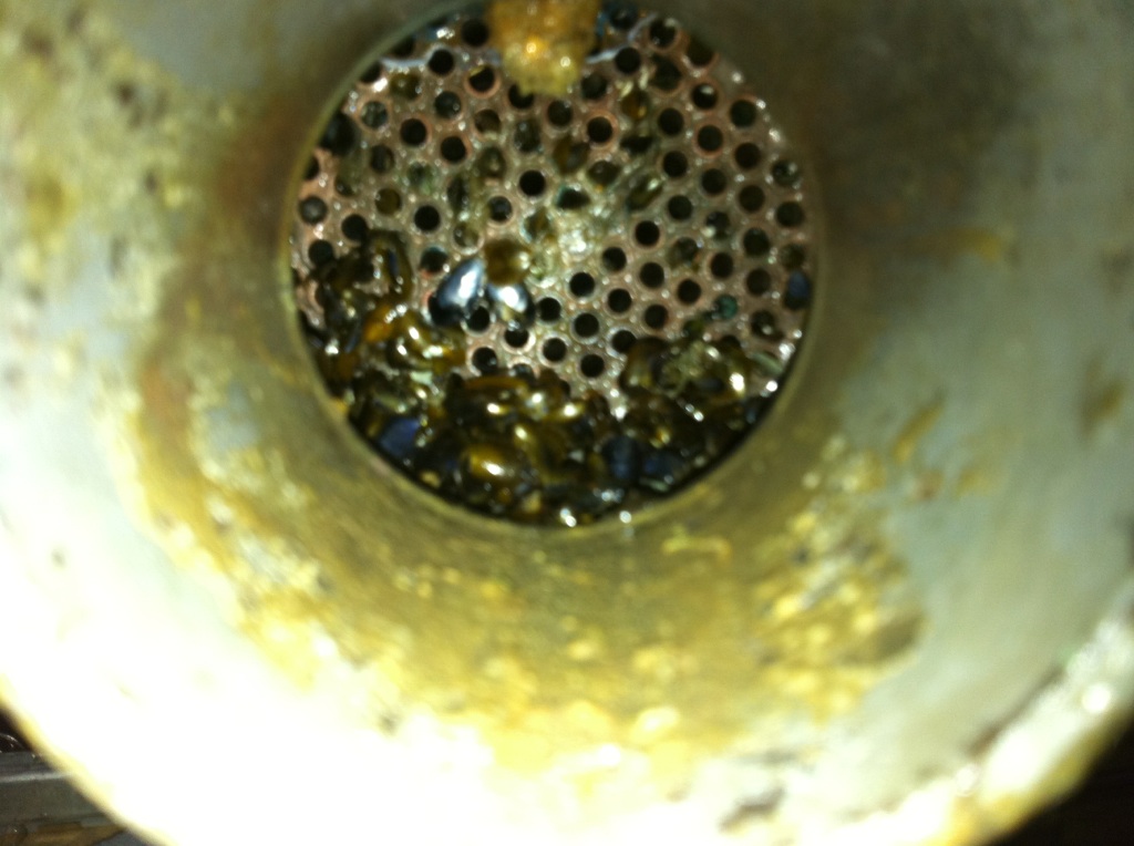

    There are lots or reasons why a boat will run hot, anything from raw water obstructions, raw water or coolant pump, heat exchanger, coolant, over fueling, head gasket, and in a DD you could have heat transfer issues with the liners.
    Also, everything in the E/R could be fine and and the boat could be overloaded with a fouled hull and running gear causing excessive drag and overfueling.
    I attached a picture of a gear cooler from a few years ago.
    This is a picture of the inlet side of the gear cooler from a 46 Post with TIB.
    The picture is of small mussels about 1/4" long obstructing the flow.
    This is what was left after most of them fell out when the hose was removed.
    (btw the engine was not running hot, but I guess it was not running as cool as it could have)
    The Post came from the factory with external Great South Bay type strainers.
    Although I am not sure if necessary, I have added sea strainers as a back up.
