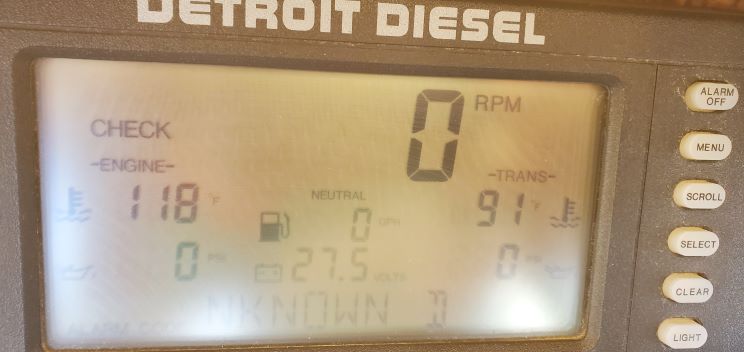

    I have twin 825 hp MTUs (Series 60 Detroit Diesels) in a 59 Marquis (Carver). Engine performance has been very strong.
    After some minor electrical work (replaced a couple of non-engine related AC breakers on the electrical panel), I started both engines. The STBD side engine started as usual with no alarm; the PORT side engine started as usual, but a Check Engine alarm went off with an "Unknown Diagnostic" code. No flash code. (See Attached)
    In an attempt to troubleshoot, I turned off breakers and power to the PORT engine and let sit for 15 minutes then returned power and restarted. Both engines started right up as usual, but the Check Engine alarm returned on the PORT engine. I silenced the alarm and idled around the marina a bit. Both engines ran perfectly with all temps and pressures identical and within the proper range. Very frustrating.
    I have read comments from very experienced Detroit Diesel mechanics related to situations like this who indicate that instead of throwing parts at the engine in a shotgun approach to try to solve the problem, the alarm should simply reset and have the user continue as usual, continuing to monitor performance very closely.
    Has anyone else experienced this with these engines? What do you recommend? Any help appreciated.

    Hi Capt Ralph, I was running an electrical heater that tripped an A/C breaker to the saloon area receptacles. Yes, when I tried to reset the breaker, it did spark. Concerned that the breaker was faulty, I had a marine electrician replace it with a new 15 amp breaker. All working just fine after replacement. Do you think the sparking had something to do with the Check Engine alarm?

    Next two thoughts;
    Get a DDEC/MTU tech out there with his laptop.
    1) Read the codes and raw data and submit that to MTU support.
    2) Ensure you have the latest software in your equipment.
    Past that, watch the vitals and run them..

    unknown faults can sometimes be caused by voltage issues. How did the engines sound while cranking? Did port crank slower?
    another possible cause would be the small battery in the engine computer. Had the issue on one of 16V2000s a few months ago although the error was “battery capacity exhausted”. Engine ran fine too

    Both engines started right up, immediately, seemed like half a crank... ran smoothly. I've learned from Capt Ralph about the connection between potential unknown codes and voltage issues.
