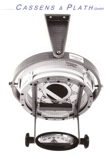

    Thanks K1W1 for heading me in the right direction! I found that style is also known as a "telltale" compass and seems to be hard to find.
    Here is a picture of one from Cassens & Plath, looks pretty fancy to me!

    Just for fun I thought I would find out how much these babies cost, not for the faint hearted!
    Cassens & Plath OVERHEAD-COMPASS/180
    with steering compass Type/11 (180 card dia.),
    mirror and lens, illumination 24vdc, longitudinal gimbaled
    complete with
    1x compass mounting brackets, pair
    1x B+C corrector device, separate
    1x D corrector (Mu-Metal induction sheets) with centre pivot
    1x Heeling corrector, separate
    1x iIIumination dimmer with box 24vdc, 5VA for flat top compass
    PRICE: SGD 3,990.00 per set (DDP Singapore)
    I guess this is a case of the right tool for the right job!!!

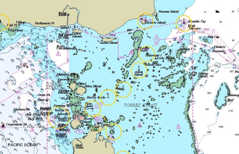

    Before the days of GPS and chartplotters, we used to use No.1 eyeball navigation, a chart and a compass. In the South Pacific you may only get one fix in 14 hours from the SatNav.
    Sailing through the Torres Straits in Northern Australia at night, in a 220 footer at 12 knots, was not for the fainthearted. You needed every piece of equipment available. Those compasses are there for a very good reason.
