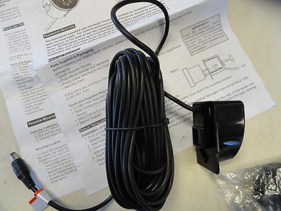

What is this..? Sitting in the bilge.

    Yep, it's a depth transducer. Probably never got glued down or was forgotten about.

    Yup, my first thought as well, but there is a thru-hole transducer already in place with another long coiled up cable so I thought this thing was some thing else..
    Any model or type for this thing..?

    Any other ideas of what the boat shaped piece of plastic is...?

    Guessing on what happened, what he was thinking (was someone thinking) could drive people crazy. Can you contact any previous owners and ask?
    AirMar usually puts a label on at least one end.
    The mounting could be of a proprietary nature. That square seems to be a possible snap in/up attachment. Maybe someone may remember a previous set up with that design.

    Thanks Marmot: That is the one.
    I do have a Hawk Eye depth finder on da Duffy, but never saw a readout for temperature. Will look under the "dash" and see if this gizmo is even hooked up to anything, if not, For Sale, never used and today Special Price:cool:
  9. Capt J
    14,530
    You won't get a readout for temperature because it's not submersed in water. That was a transom mount transducer and is why it has that integral bracket piece on it. On small boats many/some times it is possible to get the transom mount transducers to shoot through the hull and get an accurate reading. Either that, or they installed the unit and then got to lazy to mount the transducer on the transom and run the wiring through the boat and never finished the install.

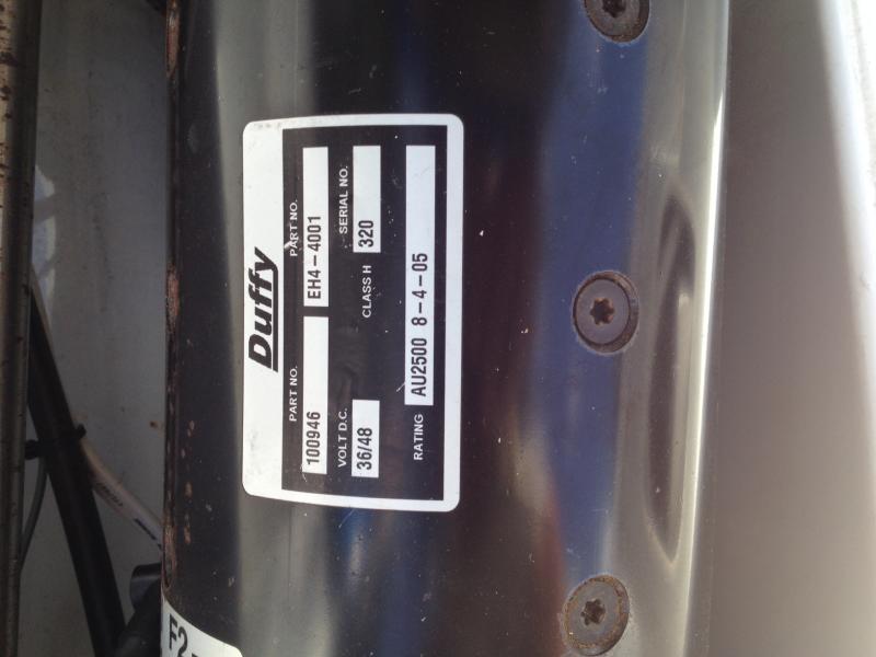

    Yeah, I need to monitor the electric motor, it get very hot after 1 hr or running, but have found no limitations or or warnings on the temp.
    Got a cooling fan in there, but probably should install another one.
    WEMA had some nifty temp gauges in the past, will see if they still have 'em.

    There might be a " Degree Rise" or " temp Rise" listed on the nameplate of the drive motor that would tell you how much warmer the motor will get, under full load, above the ambient temperature.
    This will tell you if she's really running HOT or just normally warm operating temp.

    Those DC drive motors have peculiar ratings. There is a constant power rating where you can run it until the battery is dead, and a thermal rating which is figured at the temperature the motor will reach in one hour at 10 percent over max continuous rating.
    Do you run it full bore all the time?
    You might be able to wrap the motor with as many turns of copper tubing as will fit and take water in from a little scoop behind the prop, maybe on an extension to put the opening in the prop wash to get better flow. Or get one of those DC fountain pumps. That will make a huge difference in temperature and motor life without having to deal with fans and noisy air vents blowing hot air up your leg.

    https://lh4.googleusercontent.com/-VSrjtcOY7NQ/U9a3tYEgw9I/AAAAAAAAAbI/fb_sSiA463s/s128/photo.JPG

    Tried to upload/attach a picture of the hot motor with the (only) placard, but no temp-rise ratings that I can see.

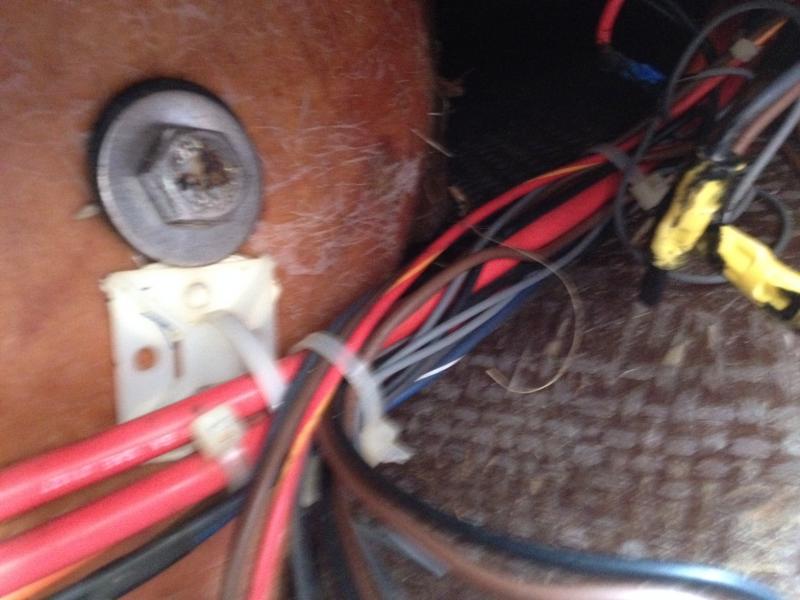

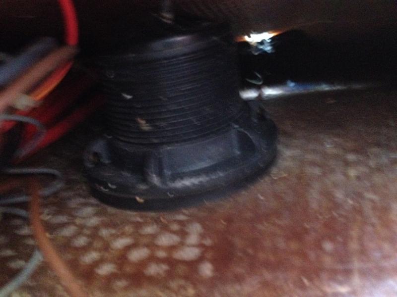

    This is the primary transducer, depth only.
    Hidden under deck...
  19. Norseman
    Norseman Senior Member
    Feb 24, 2005
    3,110
    On the other side of the bilge is this piece and it looks like the mystery temp. sensor was attached to it in the past, then fell off and ended up living in the bottom of the bilge, causing numerous head scratching and questions to wise men, only Marmot cracked that nut, what is your drink of choice, or sweet stuff or whatever? :D
