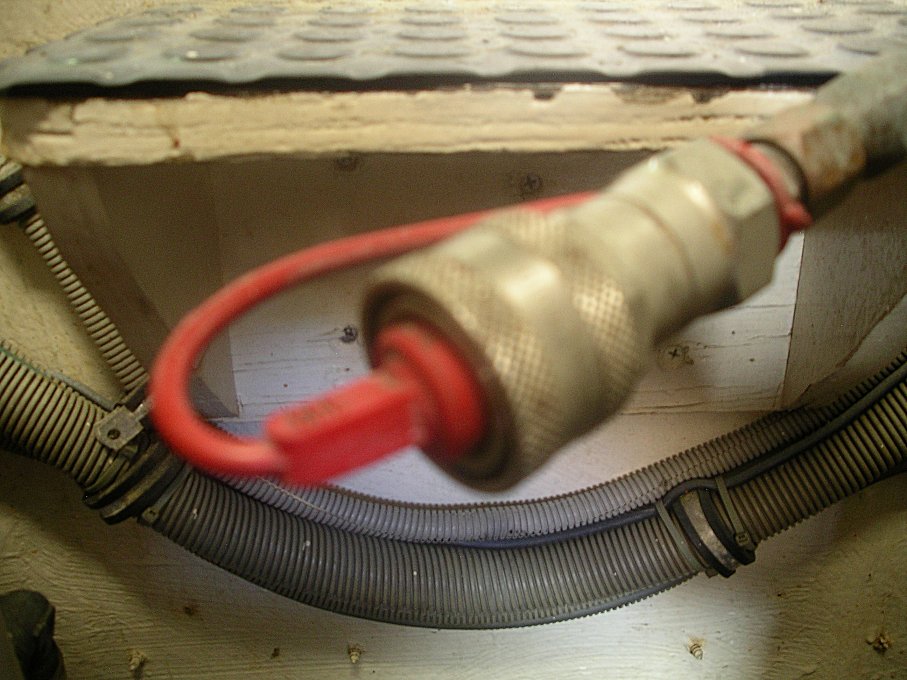

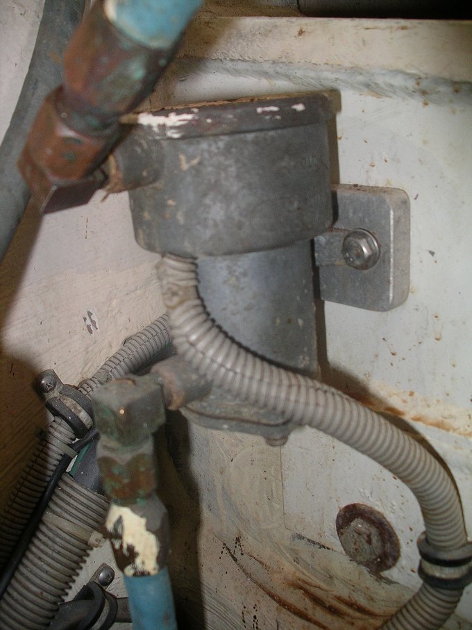

    Some type of fuel pump ? Seems one of the two lines goes to a fuel tank and the other just a 2 ft. line with a weird (see 2nd photo) to me fitting on the end. Also has a manual switch mounted below it and when turned on makes a clicking sound. Seems like a lot if only to top off Racor fuel filters when changing ?

    It's a priming pump, generally used to prime the entire engine if you lost prime, whether from changing fuel filters or an air leak or etc.

    Some old Walbro pump. Somewhere you may have the hose that plugs into that outlet. This offers fuel to filters, pails or jugs for other boats.
    I'm glad to see that red storage plug. It helps lots.
    As on my Bertram, It may have a filter before the pump. If it's a strange looking filter, it is, I have the part numbers.

    Both Man's have small fuel priming pumps on top of them, I needed after changing the secondary's awhile back so must be for the Racor's and can ditch the small 2 gal. fuel can. And, yes Ralph, there is a short length of fuel line I had been wondering about for some time but have not seen any filter. By time I learn all the "stuff," will be ready for a larger toy.

    The fitting is a typical quick disconnect. The pump might also have been for oil, but usually they're used for fuel. Could have been to empty a bladder also.

    Probably for the Racor's since it's mounted next to one of them and already has oil change pump. Suspect it was used very little so will now just clean it up a bit.

    Id guess that it's been used for the Racors as well as to fill the secondaries, hence the quick disconnect for different applications. Fire it up and confirm the function. Useful device...
