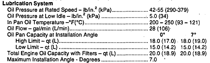

    Here's a Lube Oil Section for a DD 4-71TI rated 325bhp @ 2600rpm:

    Thank you for this info. You always amaze me with the info you can dig up. Mine I've been told are the 285 hp rating ...who knows? When I'm at J & T next time I'll give the my engine numbers and see what HP they tell me. Any way mine top out at 2350 rpm. But they never see that with me! I don't push old engines. I cruise at 1550 rpm and at times 2000 rpm.

    Wonder if the 28 gal/min stated is @ 5 psi and @ 42/55 psi ????

    The 28gpm would be at the rated speed (42-55psi). The flow rate would vary by rpm, don't know what the output is at low idle (5psi).

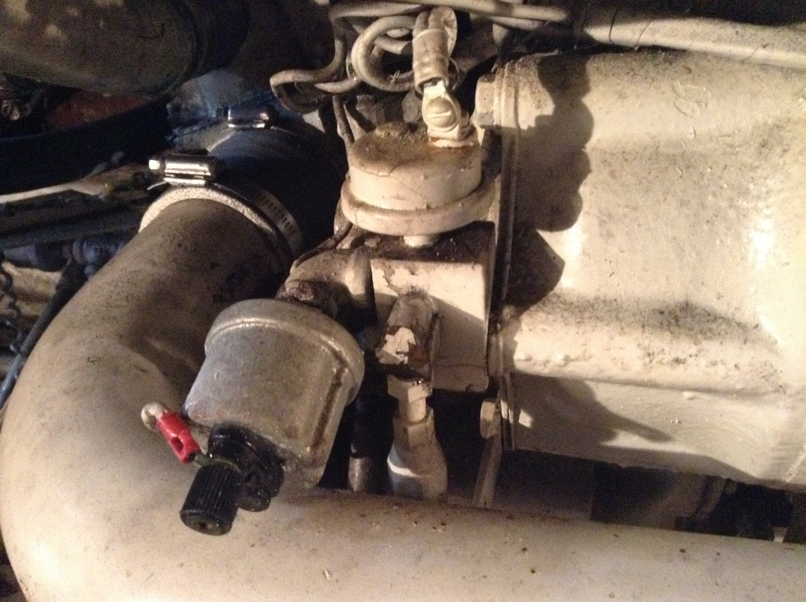

    Not sure where or which one is the oil sending unit on my engine...lol.
    I see two , one coming off the twin disc trans and another one with two lines coming off of it near the trans upper middle rear of engine...
    I think that's it?
    One single one on top of the engine center, must be the water temp sender ?

    The oil pressure sending unit is electrical.
    On DD, it's about 1 1/2" diameter, screws into block, has a single threaded post with nut to attatch wire.
    I'm not sure but I think newer engines could use a different 2 wire unit.
    Dang, can't load a picture!
    It's located on the right side of the block. It simply screws into the block and the wire attatches to the other end. Believe me, when you see one, you can't get anything wrong! It's very basic. Screw in - attatch wire.
    Only thing to remember! Never use Teflon tape or thread sealer! The unit threads must contact the block. One wire, remember?
    Looking at other responses though, I don't believe the sending unit is a problem but you should keep one on board for a spare.

    Is this it?
  19. boatme99
    boatme99 Member
    Apr 20, 2019
    44
    Tennessee
    Yep!
    Jeeze, they didn't give you much room!
  20. Capt Ralph
    13,442
    Yep, little one for the alarm, big one for a gauge.
