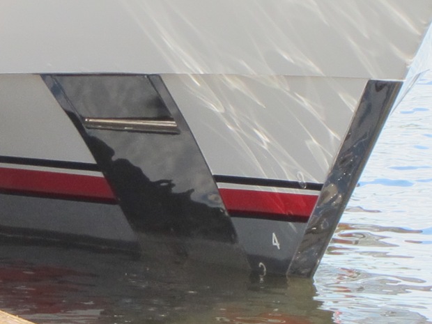

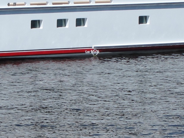

    What do the numbers represent on the bow in the first picture and what do the graphics along the water line in the second picture stand for?
    I would think the numbers on the bow represent draft but that does not make sense since the draft of this vessel fully loaded is a little over 8' and partially loaded is a little over 7'? :confused:
  2. Capt J
    14,530
    In the first picture, the numbers refer to the draft of the vessel at the bow. The second picture is the load line. The vessel shouldn't be loaded any heavier than that. Freighters have more markings for true fresh, fresh, salt, true salt.

    I think I understand the waterline markings, GL stands for the Germanischer Lloyd classification society and F indicates Fresh Water so in this case the boat is rated to be safely loaded up to the horizontal line in the middle of the circle when in fresh water. ;)
    I am still confused by the bow markings. :confused: If the marks indicate the distance from the bottom of the keel to the waterline at the bow that means the keel of the boat in the picture is a little more than 2' below water. In actuality she is drawing about 7.5'. The 8 mark could be correct as her max draft is a little over 8'. In reality the distance between the 2 and 8 marks is only about 2'. In this case since her keel is about 7.5' below the water shouldn't the mark be a 7 instead of a 2??

  5. K1W1
    7,427
    The keel or deepest part isn't attached directly below the bow normally.
    This is the draft forward, as she loads fuel she will no doubt go down by the head more than overall so when full and that boat looks like it has been down by the head a lot she will be even on her marks.

    In the top picture the center lineof the circle is the salt load line, the line next to the F is the freshwater line.

  10. Innomare
    Innomare Senior Member
    Dec 5, 2004
    233
    I don't know if they do it any differently in the States, but usually the draught numbers are in dm (decimeters). So 4 would mean a draught of 40 cm.
    That also seems to be correct with your statement that there's about two feet between mark 2 and mark 8.
    That said, the numbers seem to be very low to me, because even forward, you should be referring the draught to the baseline, not to the local deepest point. That way, if you read the same numbers fore and aft, the boat is "on even keel".
    Bruno
    PS - looking at the numbers, I think there's perhaps a number 2 missing in front of each number. Numbers would then be 28, 26, 24, 22, which would represent 2.8 m, 2.6 m, 2.4 m, 2.2 m draught.
  11. discokachina
    discokachina Senior Member
    Mar 21, 2010
    1,287
    Thanks Bruno, that makes perfect sense.
    8 = 2.8m = 9ft 2in
    6 = 2.6m = 8ft 6in
    4 = 2.4m = 7ft 10in
    Those numbers match her published min and max drafts! Mystery solved! ;)

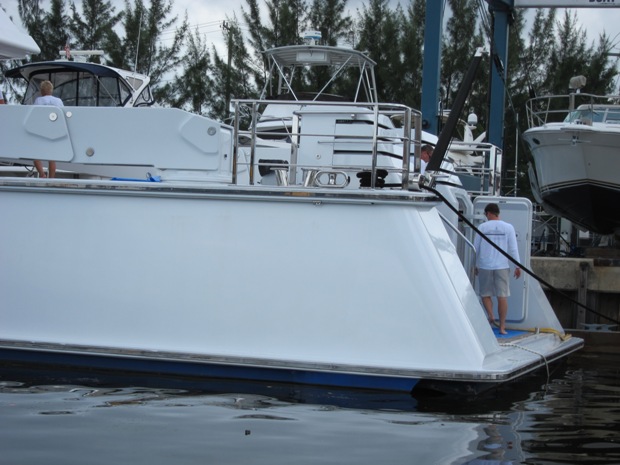

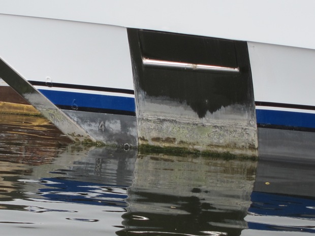

    1,287
    I can't see any numbers on any of the pics have of her stern. I will have to try and get some of below her swim platform.
      87.7 KB
      2,799
  14. NYCAP123
    11,208
    I see a reflection of something in the blue paint about 4' forward of the stern. That looks like it.
  15. discokachina
    Mar 21, 2010
    1,287
    I went back and looked at the pic again and see what you might be talking about. But, on second look I also notice what I think is a "3" about a foot to the right of where the bright blue paint turns almost black just before the side turns into transom. Would a 3 make sense? 2.3 meters = 7.5 feet which is the vessels min load draft?

  17. NYCAP123
    11,208
    Sorry, I'm used to seeing that in feet which is what it appears to be at the bow. I also can't imagine them leaving the 2 in 2.3 meters to the imagination nor using fractions of feet or meters. Since I can't actually see it, I'm going to guess that (from what you've written) that the "3" is actually an "8" with maybe a little heavy handed painting on one side. Meaning that the stern is just under 8' draft and the bow normally (per the water stain) at just under 6' but currently just over 3'.
