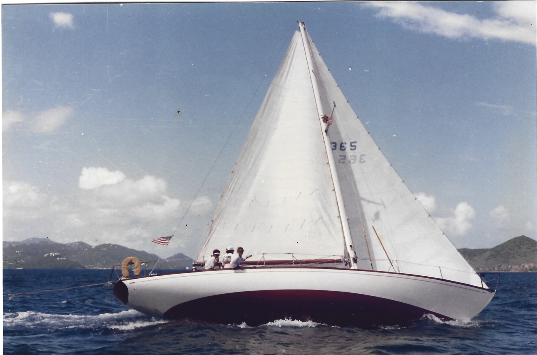

    Surfing indeed.
    That was also the secret of the Bermuda racers with a lot of overhang and a short waterline:
    This was my first boat, a 44’ Bill Tripp Jr. Bermuda Custom: 30’ waterline but when she heeled over she surfed on the side and sped up. (Everybody hang on..)
    The previous owner reported 12 knots, I only saw 10.5 during my ownership, but we removed the mizzen mast for repairs and never re-installed it.
    This picture probably from Foxy’s Wooden Boat Regatta in Jost Van Dyke: We won the race but disqualified later as we had started in the wrong class: 39-43’ instead of 44’ to 47’: I was too lazy to hit the skipper’s meeting the night before and they had changed the starting times during the meetings..:rolleyes:
