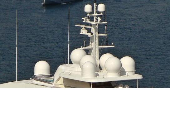

  5. K1W1
    7,427
    Here is a Picture of the "Pumpkin Farm on the Roof"

  10. K1W1
    7,427
    That is the whole point of doubling up the domes.
    Even when you only have 1 Satcom dome you will find headings where the mast is in the way unless it is ontop and then a cable wrap can catch you out.
    The boat in the photo had 6 TV Domes, they tracked 3 Satellites with two domes for each one , the one with the strongest signal was the one used to supply the system.
