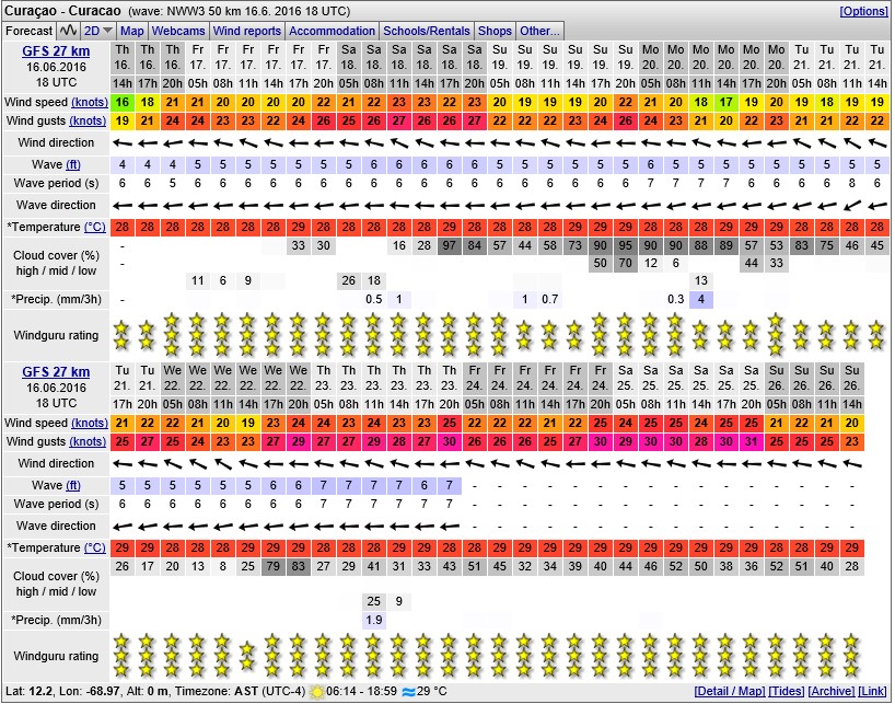

    Just wondering... I read a lot of comments that people don't go out if waves are over 3 ft... we almost never have it less then 4ft and I go out on almost every wave height!
    So therefore am I comparing the right figures, please see below of our actual situation on Curacao:

    I use the WindGURU free version, and we all find it very accurate!
    FYI, we almost never see less then 4ft measured top to bottom, and we find that a real quite sea...
    One time went to Bonaire on a 10ft (measured top to bottom) sea... that was quite a ride, but no problem at all, just took an extra hour (before the rum)...

    FYI, I found the definition of the wave number in my WindGURU sheet:
    Significant wave height in ft. It is the average height (from wave crest to trough) of the one-third highest waves at a location.
    More details, see: http://www.windguru.cz/int/help_index.php?switchlang=1
