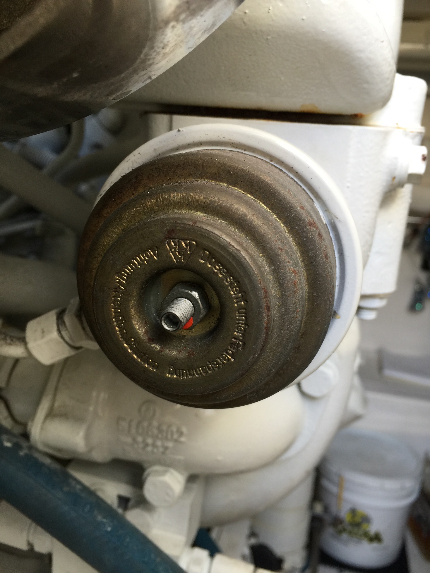

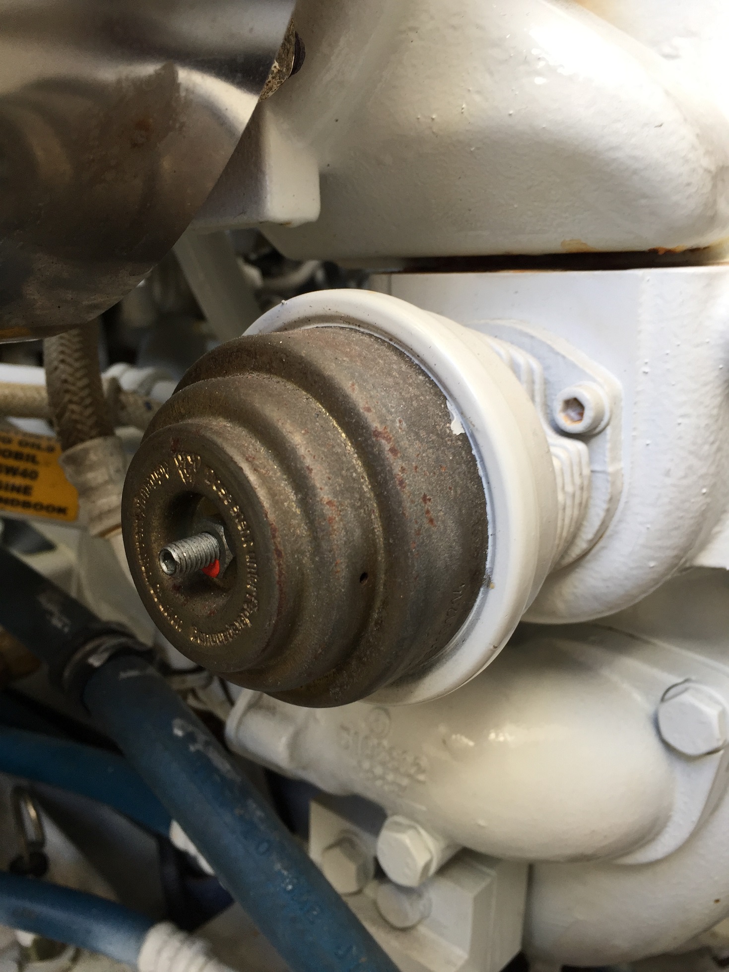

    Here is a picture of the one on the port engine inside. IMG_1880.JPG IMG_1880.JPG

    Wondering if the spring inside gets stuck in the open position would this create extra soot?
    Since you mentioned the charge air flow I believe that is shown on my Man instrument although not sure what the correct reading should be. Its not enough to set off an alarm.
