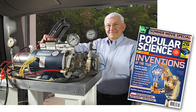

    I was cruising thru a June issue of Popular Science and ran across an award that had been given to this potential onboard sewage treatment device. I thought it definitely deserved some discussion on these forums.
    "What if we could eliminate sewage? The ZLD virtually does just that! It takes the sewage (solids and liquids), grinds them up and homogenizes the solids in the liquid.
    The ZLD then takes that liquid (that looks like chocolate milk) and pressurizes it and sprays this liquid into the hot exhaust gas of the engine. The hot engine gas vaporizes the liquid, and kills the bacteria and basically eliminates the sewage with no odor no liquid or no sludge to handle."

    I don't see where he is dumping into the 'machinery', (or boiler as you might have experienced). It appears as it is dumped into the exhaust at very near the exit point?
    ...and it appears as though it has received a US Coast Guard Certification

    Well I was wrong here, he is injecting in the manifold area. And if the engine is turbo I'm sure it would have to be after the turbo.

    Here we go again...this idea re-surfaces about every 10 years. It was
    first tried in RVs about 30 years ago...and it actually seemed to work
    pretty well....at least till the animal fats in waste began clogging up
    catalytic converters and mufflers. There was also one more minor
    problem: unbearable odor that gassed everyone in vehicles up to a
    quarter mile behind an RV equipped with this system. So...it didn't last
    long.
    Several other would-be inventors have tried to make it work in RVs with
    no better success...but the first--the ONLY--attempt to put on a boat
    was about 15 years ago. Some Europeans put one on a muscle boat...it
    worked, they put it on the market for a couple thousand bucks. What THEY
    overlooked was, very few boats except muscle boats have dry
    exhausts...and wet exhausts don't hot enough to incinerate anything.
    Plus, there was still that pesky odor problem and those darned animals
    fats. It was a short-lived venture.
    Now, here we go again... This guy CLAIMS to have solved the odor
    problem, but doesn't address the animal fats (it takes some time and/or
    some VERY heavy toilet use for those build up enough to start to cause
    problems, so he may not even be aware of it yet). So while it may work
    on a RV, it still wouldn't work on most boats because most boats have
    wet exhausts. However, I see on his website http://www.thezld.com/ that
    he's had it "certified" by the CG and the EPA, but he doesn't say WHAT
    he's had it certified as (plus, the EPA doesn't certify anything)...I
    don't THINK it's as a Type I or II, but I'm gonna call him in the
    morning to find out.....Peggie Hall

    The certification just states "Marine Sanitation Device" and that it meets the standards for BOD,fecal coliform limits, and suspended solids.
    Keep in mind that a USCG approval does not mean something is practical, maintainable, or even rational ... it just means it meets a narrowly described set of functional tests.
    http://cgmix.uscg.mil/Equipment/EquipmentDetails.aspx?EQID=16123
    Bollinger seems to have been involved in this effort at some point but I can't find anything that still connects them with it. Something just doesn't smell good about this whole thing.
