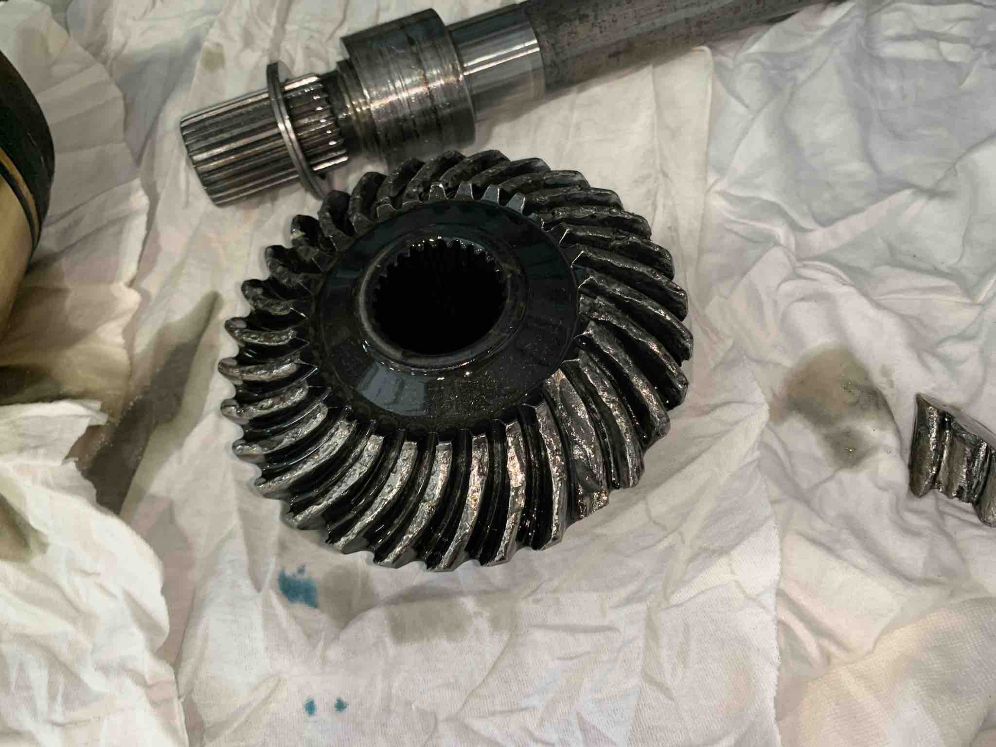

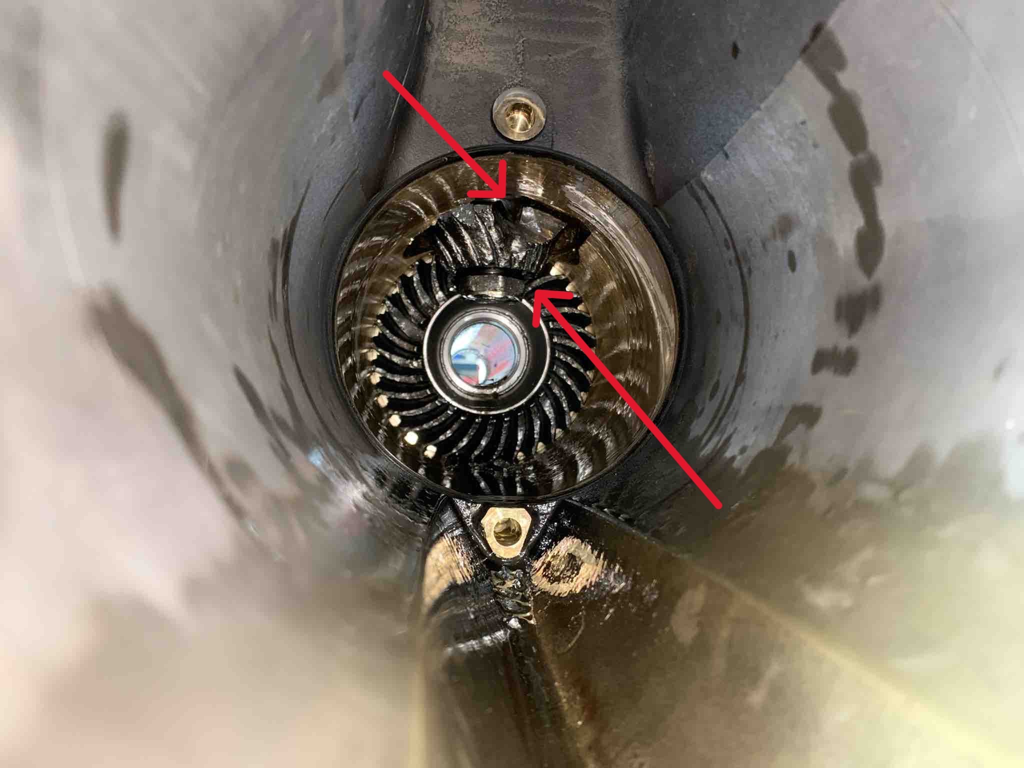

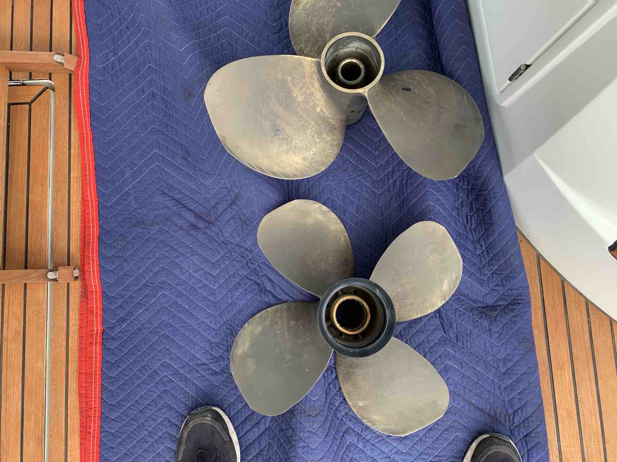

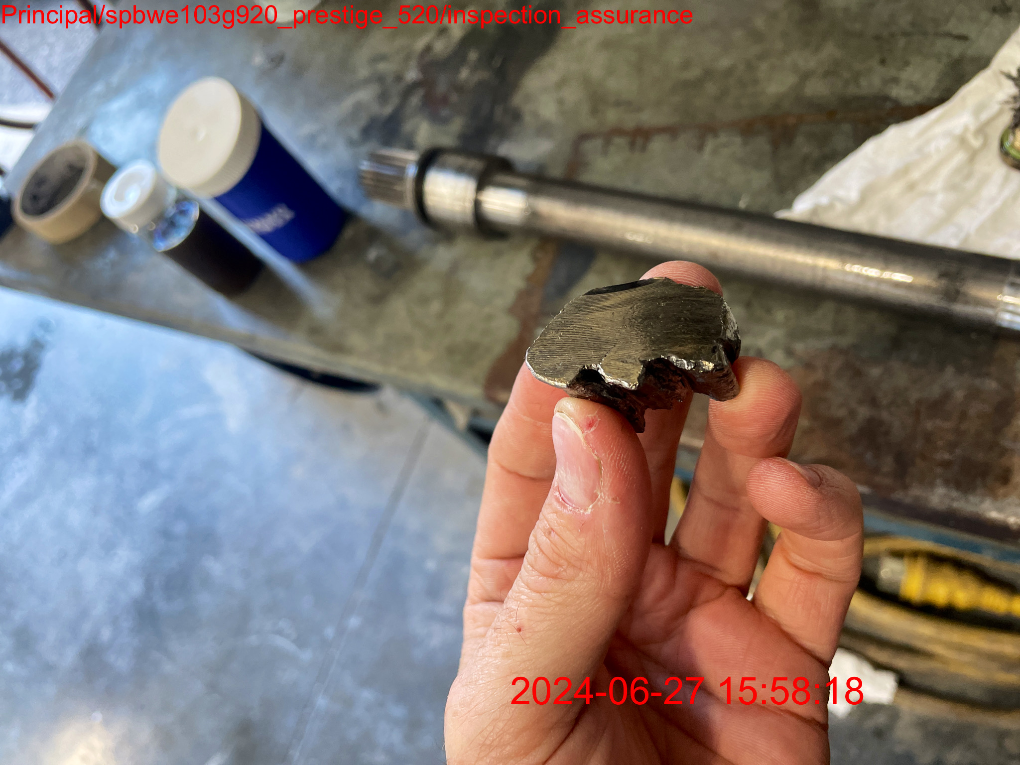

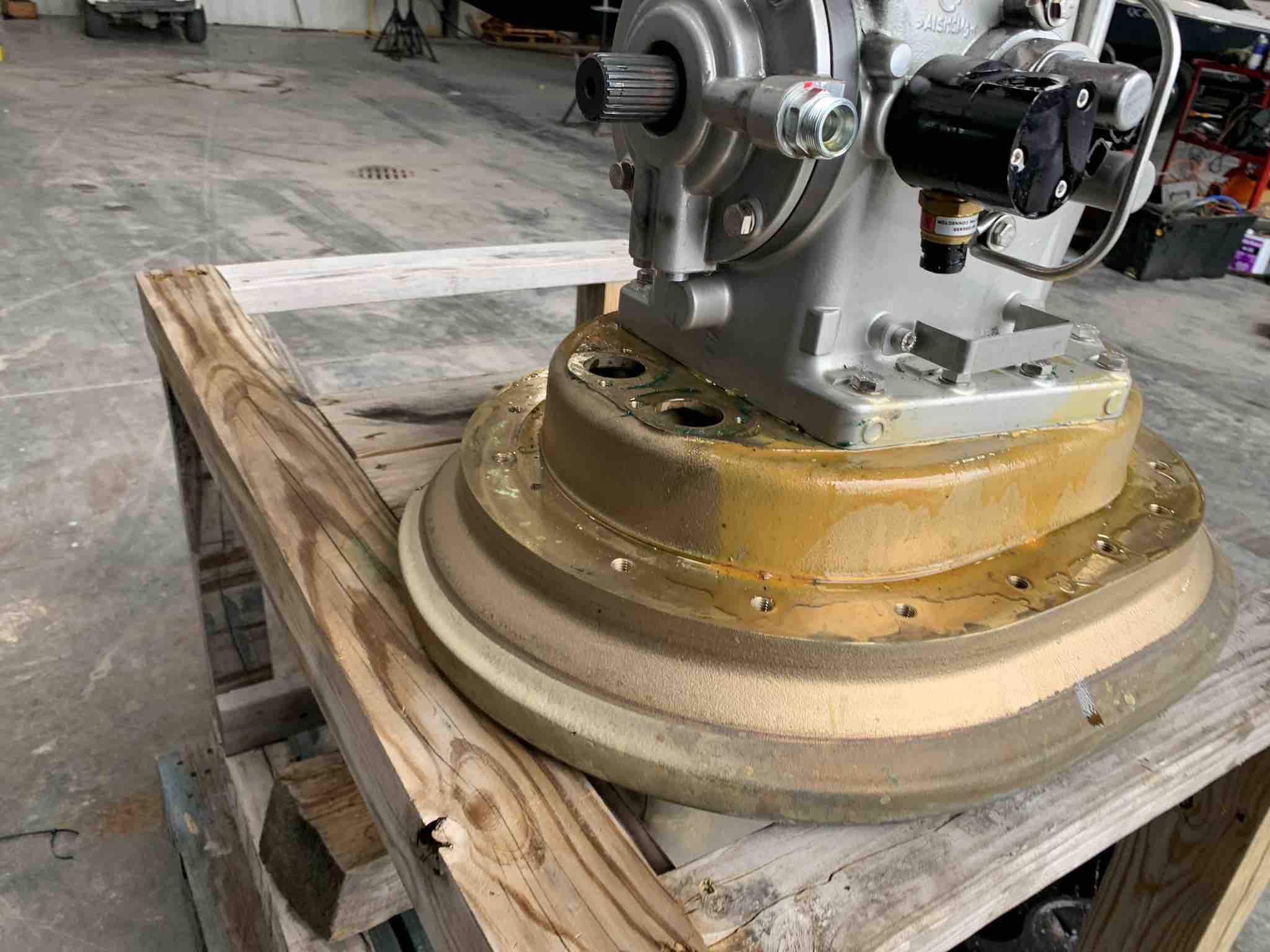

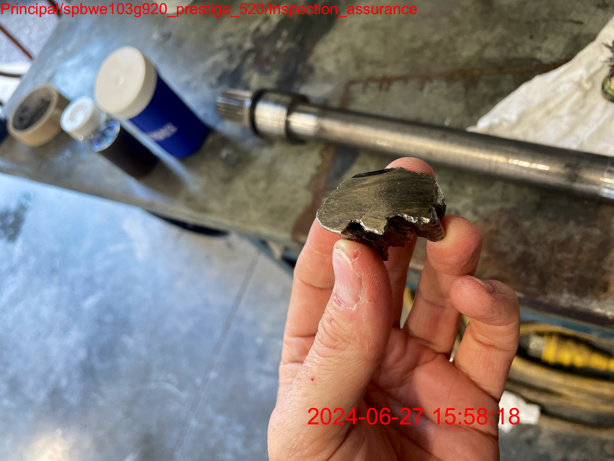

  10. JustinMet
    JustinMet New Member
    May 4, 2021
    11
    Montreal, Canada
    Many thanks, here are some pictures.
    No propeller damage.
    Lots of metal debris in the oil
    Transmission and IPS to be changed but I don't have much details at this stage.
    I will have more for sure. In relation to insurance, as there was no incident at all, I don't see how this would be covered?
    You can make sure I will push and ask for a meeting on site with relevant persons. I was told my dealer has the diffent broken pieces on site.
    Thanks again, This is very helpful. I will try to get answers to your questions.
  11. Capt Ralph
    13,434
    Yep, As I described (Boom).
    Good luck on all.
