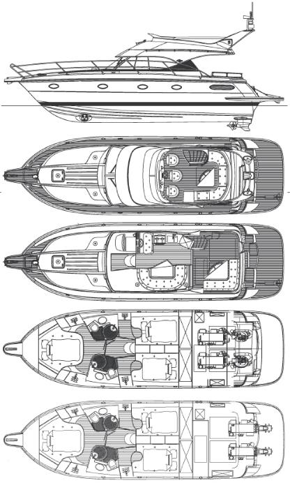

    We have a couple of Swedish brands offering both alternatives in a boat, the latest out is the Nordwest 420. As you can see on these drawings from Nordwest the IPS installation takes up a lot more of the space in the engineroom. Accentuated by the neat Duoprop package where the D6/350 comes very close to the transom.
    So, today I think boats around 10-12 tonnes might benefit from the IPS, with a less heavy boat the Duoprop is still a better option.
