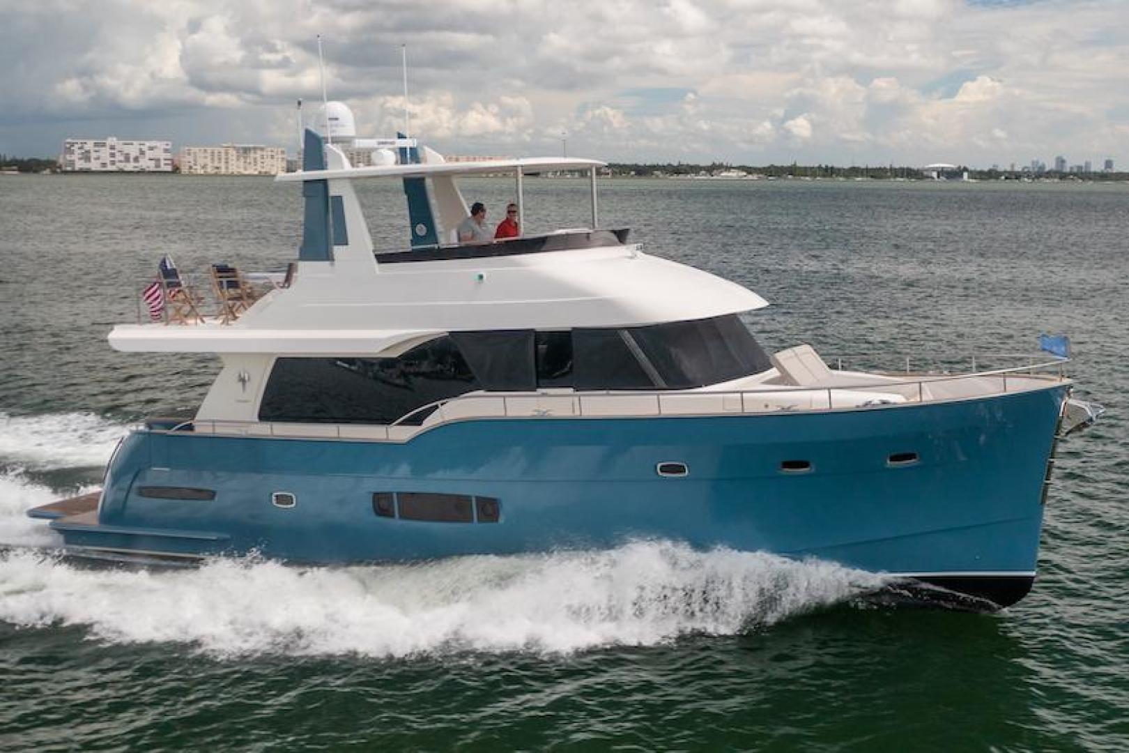

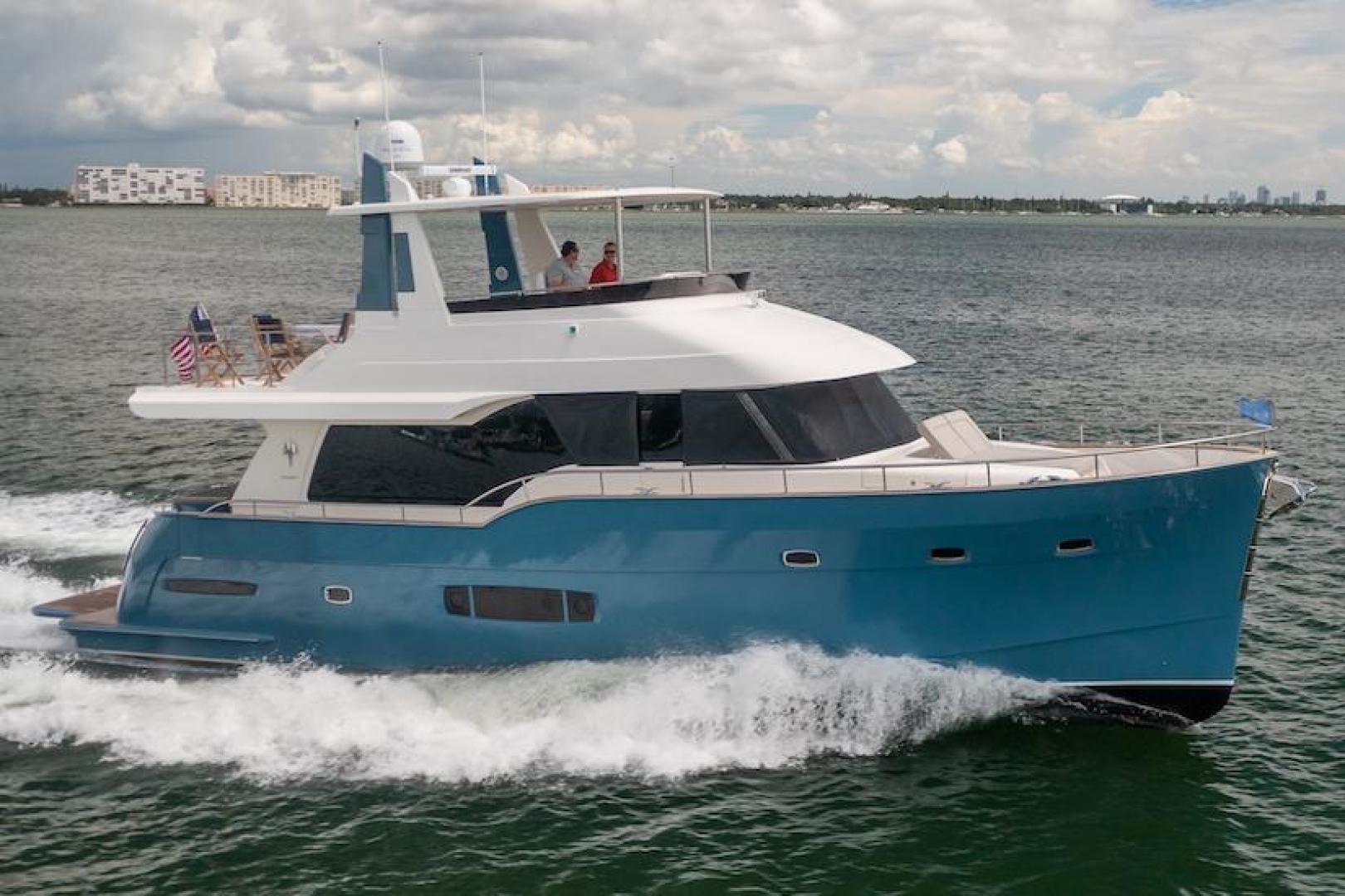

    So I am interested to see this thread, but sorry for your complete aggravation, as you said, Life Thief! Our most important thing is time, and we never ever get it back. The reason I am interested to see the thread is we have been considering a boat with pods. Maybe this thread has answered my question. And for a number of years I have been told to stay away from Cummins Zeus due to their breakup for one, and to only consider the volvo. BTW, we did test the Schaefer 660 in St Pete, that was a fast boat. How's the rest of the boat been?
    This Outer Reef Trident 62 below is kinda a cream puff as it has been under cover and my wife likes Maximo, a hard to get covered slip can come with the boat I am told. Big price drop, but I think I will pass. And they are going to V drives on the Trident. That should tell us everything we need to know. Pods are a great idea, that seems to have issues.
