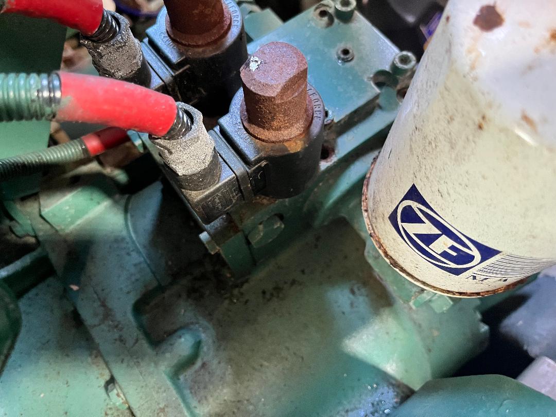

    I purchased a Cranchi 50 last year with D12s, very happy with how they run for sure. The motors had fresh fluids, but the transmissions weren't done. I've been going through things and have already replaced the air filters and Racors. Late last season the port side motor tripped a "maintenance required" message on diagnostic display. The turbo pressure guage reads .2-.3 bar lower as well. It seemed to build revs much slower than the starboard, but eventually would reach max rpm. My sense is the secondary fuel filters that mount directly on the motor, need to be changed.
    1. Can you just unscrew the old ones and put the new ones on, or does the system need to be bled?
    2. Late last season when we were going to bring the boat to its winter storage location, the starboard motor didn't want to engage in gear. Did a little research and understand the issue can be caused by a clogged screen in the hydraulic gear actuator. A couple days later, it engaged in gear no problem, but I suspect it might happen again when its more of a big deal. Has anyone done this maintenance on their own, and how difficult was it?
    I profess to not be a longtime boater, but longtime like to maintain my own equipment when ever possible. Thanks in advance.

    Replace the filter, there is a manual fuel primer plunger on the fuel pump, Pump on that until firm. Crank her up...
    Basic hydraulic fittings. I don't think this is your problem but if you insist on opening Pandora's box, start here.
    Your local VP or ZF shop can provide new screens and seals as needed. Maybe some better support.
    All above can be supported better by getting tight with a better VP shop.
