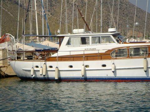

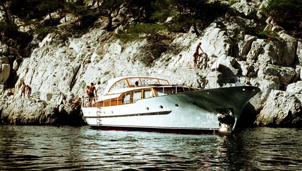

    It occurred to me that you may be interested to hear about the rebuild of my 60yr old steel motor yacht - a vintage 61ft Feadship - Alto Volante (ex Tiki, ex Lenton Rose ) built by van Lent in 1960 , which apparently spent many years in (I believe) Rotterdam and then on the Dutch waterways before moving to the Med in the 1980s, where I found her
    I live in London where I work as a music publisher and I am a lover of interesting and beautiful boats of all types. I’ve owned and restored various wooden yachts (ranging from a 12ft American catboat built in 1900, a 25ft 1930 estuary motor-cruiser, a 1950's BB11, a 34ft 1959 sloop, a 26ft 1938 ChrisCraft and, latterly, Amokura a stunning 51ft Fred Shepherd designed yawl built by Moody’s in 1938, and that I rebuilt over 7 years, before selling her because my young sons didn’t like sailing!) I then decided that my next project would be a small classic motor yacht that my family could enjoy and use without a full-time crew. Eventually, I settled on Tiki, which I found lying in very poor condition, in Pollenca in N. Majorca.
    We did some work on her in Spain, using a combination of the local yard staff and a variety of itinerant and in the main incompetent labour. This involved large section of rusted bow being re-plated, replacing so so-called "new " teak deck (that had been laid on the "old"teak deck without attending to the rusted structure beneath) , replacing the worn out engines and boxes with re-built Gardners 6LXB engines ,fitting new stabilizers, bowthruster and shafts etc .
    That was a very slow, frustrating and expensive process. After 3 years I finally realised that completing the work by remote control in Majorca was going to be uneconomic and an impossibly long process. Accordingly, as soon as she could move under her power we took her to the Classic Works yard at La Ciotat in France. Doing work there proved to be impossibly expensive for me so we took a deep breath and took her through the French canals back to the East Coast of England, where she is now entirely stripped out and waiting for work to begin at “Landamores”, a well-known family owned & operated boatyard, known for the quality of its workmanship and at a price that will be approx 50% of the rates quoted in France & Spain.
    work remaining to be done:
    rebuild entire interior in light oak
    rewire & re-plumbing throughout
    build new Pilot-house
    sort out rusted fuel and water tanks (not sure how, yet!)
    more hull plating
    much else.....!

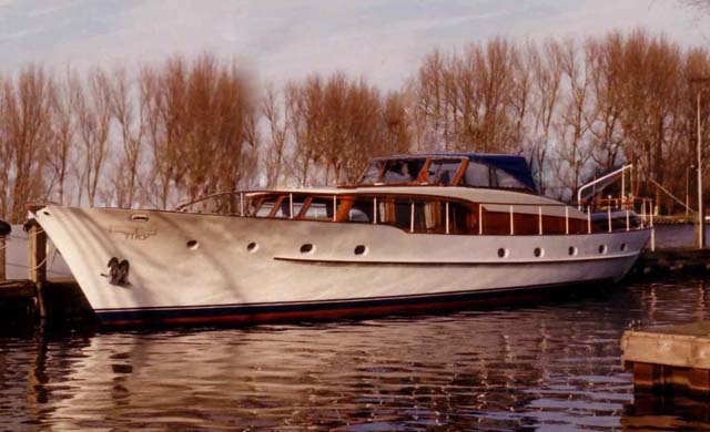

    Tiki is an interesting boat - she was built with a typical Northern European displacement hull with a flared bow, but with a superstructure based on 1950's planing ChrisCraft design - presumably with a view to selling her to the USA, which as I am sure your are aware, was the reason for the Feadship federation of Van Lent and de Vries yards, in the early fifties.
    Tiky would look lovely with the original open helm but I'm not sure that is the best/most practical solution for a 61ft displacement yacht which will be used as a family holiday boat in the Med, or even if it is the most aesthetically pleasing, so were currently looking at alternative designs
    More posts to come as the work progresses…could be a while , though!
    best
    D

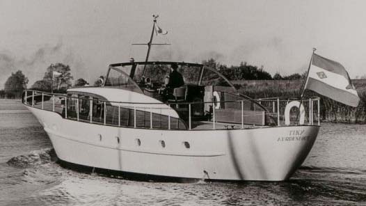

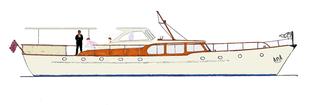

    Pilothouse for vintage 62ft feadship Tiky
    Believe me, adding a PH is not something I will do without a great deal of thought - clearly , doing so will change the way she looks and may detract somewhat from her sexy 1960s curves (but not nearly as much as did the 1980s addition which Ive posted). Bear in mind she is a displacement boat with a max speed of around 11 knts, rather than a fast sports boat, which i think has some bearing on how she should look. I also have to think about how the boat will be used -ie as a family boat in the Mediterranean where in Summer it is either too hot, or in winter toocold and wet for there to be no shelter. I considered a bimini top but I dont think that works visually on Tiky and since it would be up all the time, it might as well be permanent. I am therefore considering a small "cuddy" type structure that will be in white, rather than teak, and open at the rear so as to be less heavy visually. In any event Id appreciate your thoughts on my design (which is far from final)

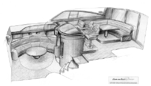

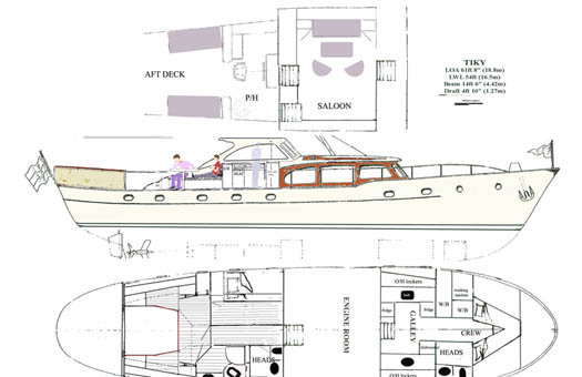

    Feadship Tiky GA with proposed new Pilothouse
    here is the General Arrangements of what i had in mind for the new PH

    I like the PH concept you've posted...very well-conceived. Do you plan to do it up in fiberglass?
  11. david_japp
    david_japp Senior Member
    Feb 7, 2005
    369
    london
    Im Not as yet certain as to constaruction method - possibly ply sides and either strip- planked or balsa core roof and radiused edges ...all encapsulated in epoxy.

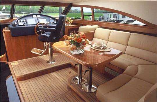

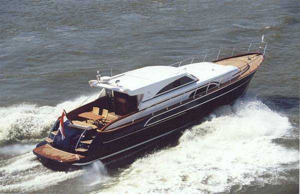

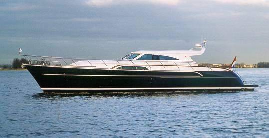

    ANother Option
    In keeping with her Netherlands origins. From Mulder:

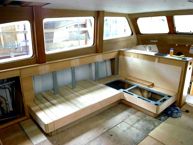

    Am I allowed to beg for interiour fotos? I know this is your private area but i´s love to see some. It seems that you really gave that ship a second life.

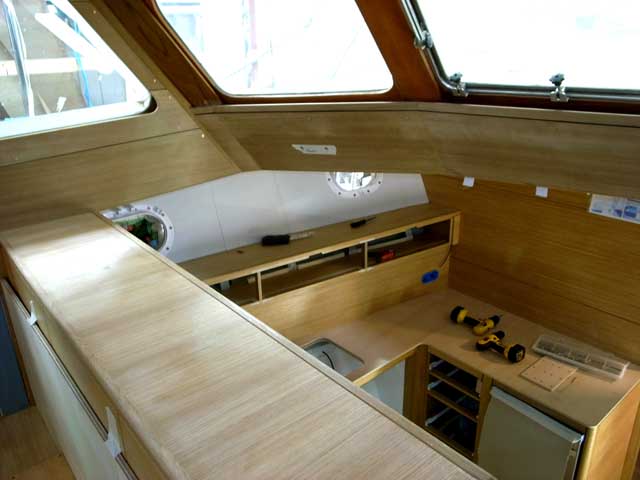

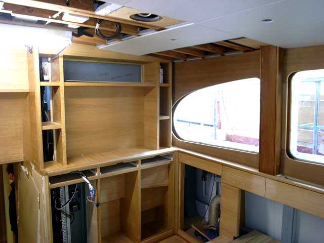

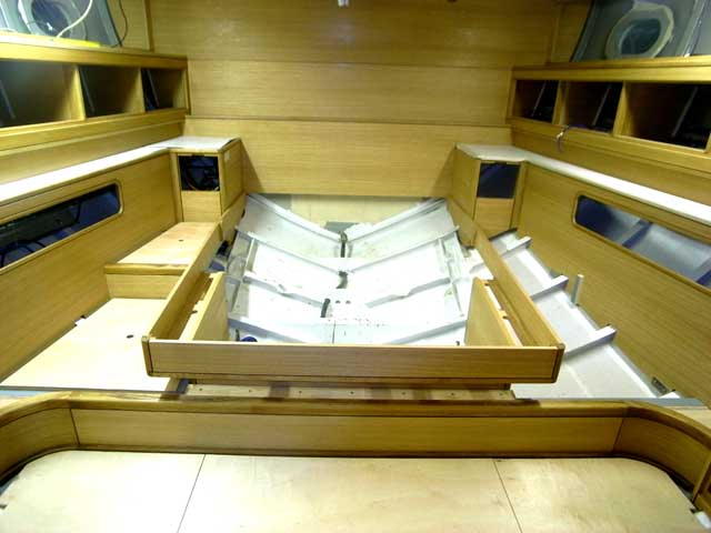

    Hi
    of course you may photos ! ...here are some photos of the aft cabin and saloon in mid-build, approx 2 weeks ago. FYI the entire interior has been rebuild in American white oak with horizontal grain and horizontal shadow gaps that break the BHs etc into "letterbox" shaped panels. The cabin sole will be teak.
    I'll have other more up to date pix of the interior that I will post after I visit her at the end of this week.

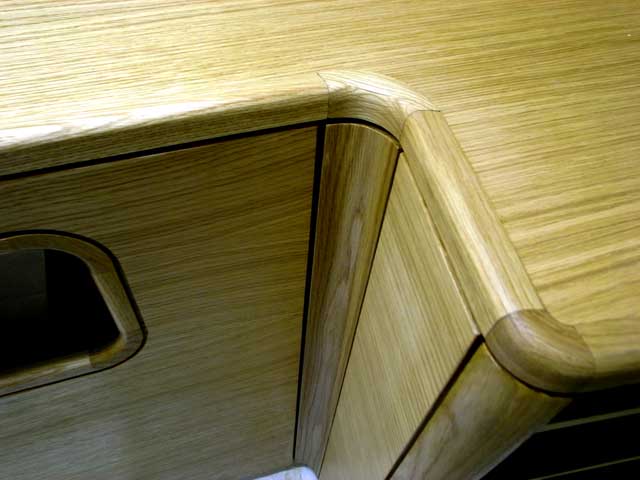

    Beautiful work so far! As an amateur wood worker, I would love to see some close ups of the joinery work on the bed platform
  20. david_japp
    Feb 7, 2005
    369
    london
    Hi
    thanks ...I'll try and post some close ups during the week , but if not I will be able to after next visit
