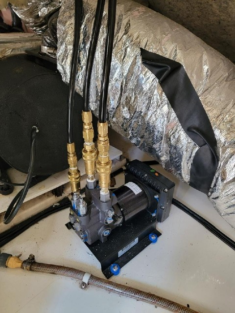

    Not sure if this will help but I just had an autopilot (Garmin) added on my 1995 54 Viking MY with one helm. There are shut off valves outside of the picture.
  7. Capt Ralph
    13,443
    I do luv those quick disconnect lines on the pump in post #6.

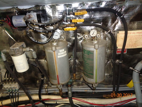

    Here is an install pic (non Garmin) from a few years ago.
    Reservoir and AP Pump with valves.
    You may never use these valves. When you do, you will be so happy they are there.
