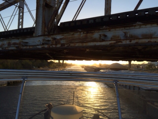

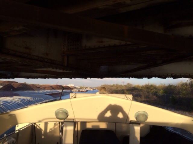

    Here is a vantage point on 10/15/15 going under the infamous bridge on the Cal Sag on a 1981 56' Hatteras. More room than usual on this particular day. I have now done this trip on two different 56' Hatts and can't say enough good things about them.
  14. Capt J
    14,532
    Hehehee, I have the same picture when I went through on the 75' Hatteras.

    Awesome pics, thank you for sharing! I have to say, that still has to make the ole ticker skip a beat. I mean, I'm getting tense just looking at it from the comfort of my desk. I would still like to be in your chair and not this one, especially this time of year. Enjoy the rest of your trip!
    Scott
